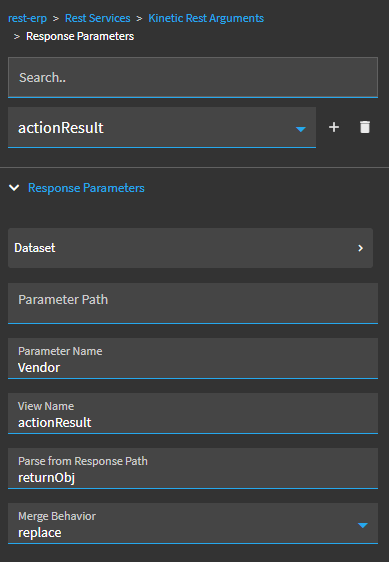

Here’s how I’m trying to get to it:

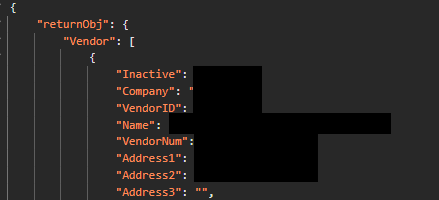

This is the response, and I can see that it has the data I’m after. I also followed the post and recreated my widget, still no luck I’m afraid.
No, I used a custom view, actionResult is too unreliable as it can get overwritten by another process running in the same sequence.

The main thing that was throwing me off here is ‘Dataset’
Although I didn’t know it, if you dare to click that ‘Dataset’ the widget has to be recreated or your results will always be undefined. It doesn’t matter if you add anything or not inside ‘Dataset’, the widget will be broken regardless.

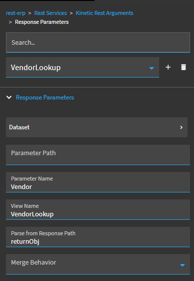

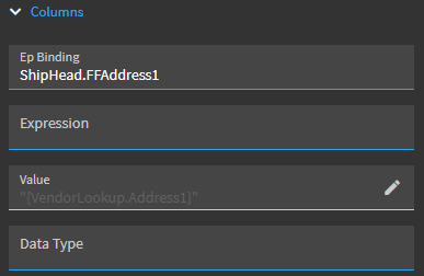

I also found that in my row-update, I didn’t need to target [0], Kinetic does that on its own. Same result as you with actionResult too, I had to create a dataview that I called ‘VendorLookup’ and then store the results in there.
So, if it for anyone else:

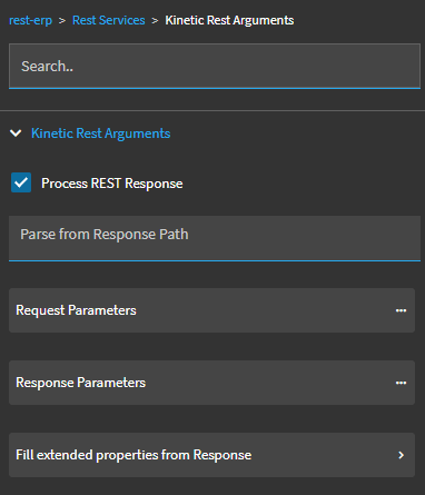

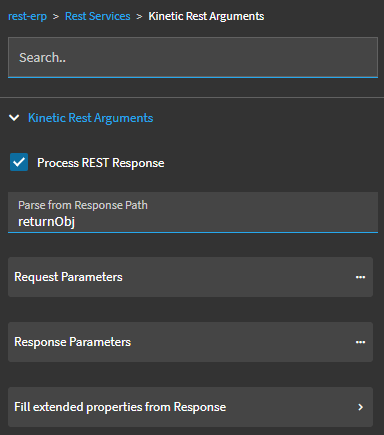

Leave this blank
Parameter name = object you’re targeting
View Name = the one you created (don’t use actionResult, seems a bit iffy)
Parse from Response Path: I haven’t seen it be anything else other than ‘returnObj’, but it’s just the top level of your results.
My row update looks like this:
