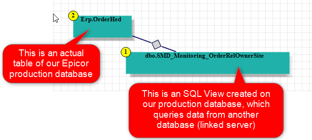

We had the same issue, our old data was in a different database that our current Epicor database. Here’s what we’ve done
  1. With SSMS, Establish a linked server, from your current production SQL database to the old database
  2. On the current production database, create a sql view in which you query the data from the old database

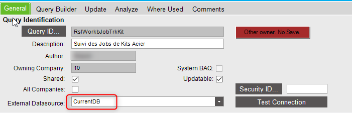

  3. This may seems weird, but create a external datasource “CurrentDB” that point to the current SQL Database of your prod environnement.
  4. Still on the current production databse, create an external BAQ and configure the BAQ to be connected to the datasource “CurrentDB”
  5. Now, in your External BAQ, you will be able to reference both the SQL View (querying the old database) AND all the current database tables. You can join them together and do stuff
