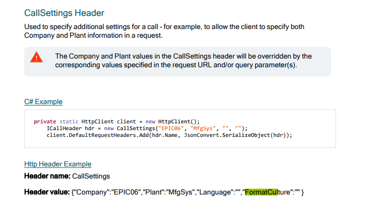

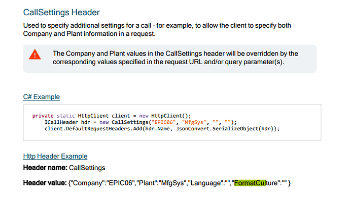

The REST Services Guide from EpicWeb indicates the usage of the CallSettings. In addition to switching company or plant, you can also choose the Language and FormatCulture.
