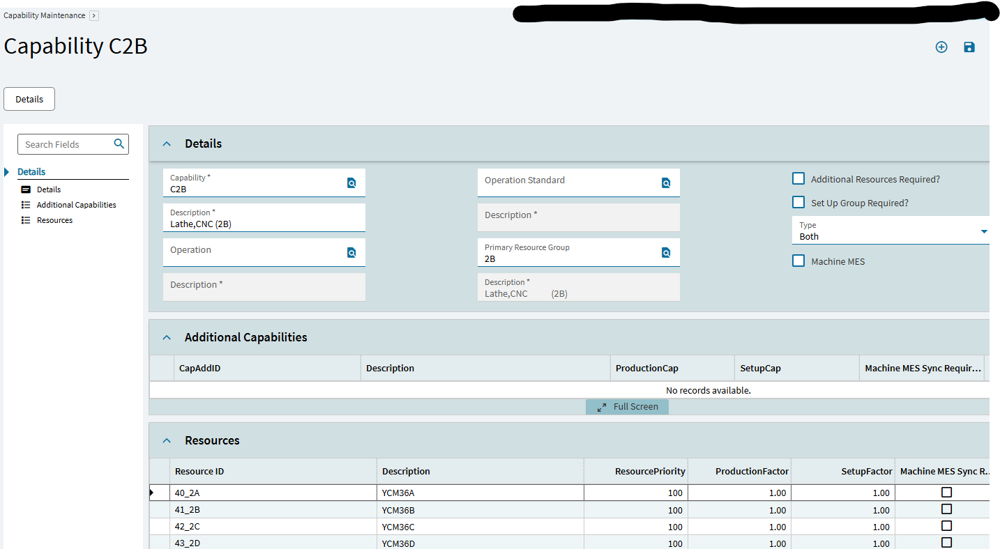

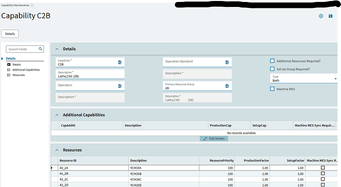

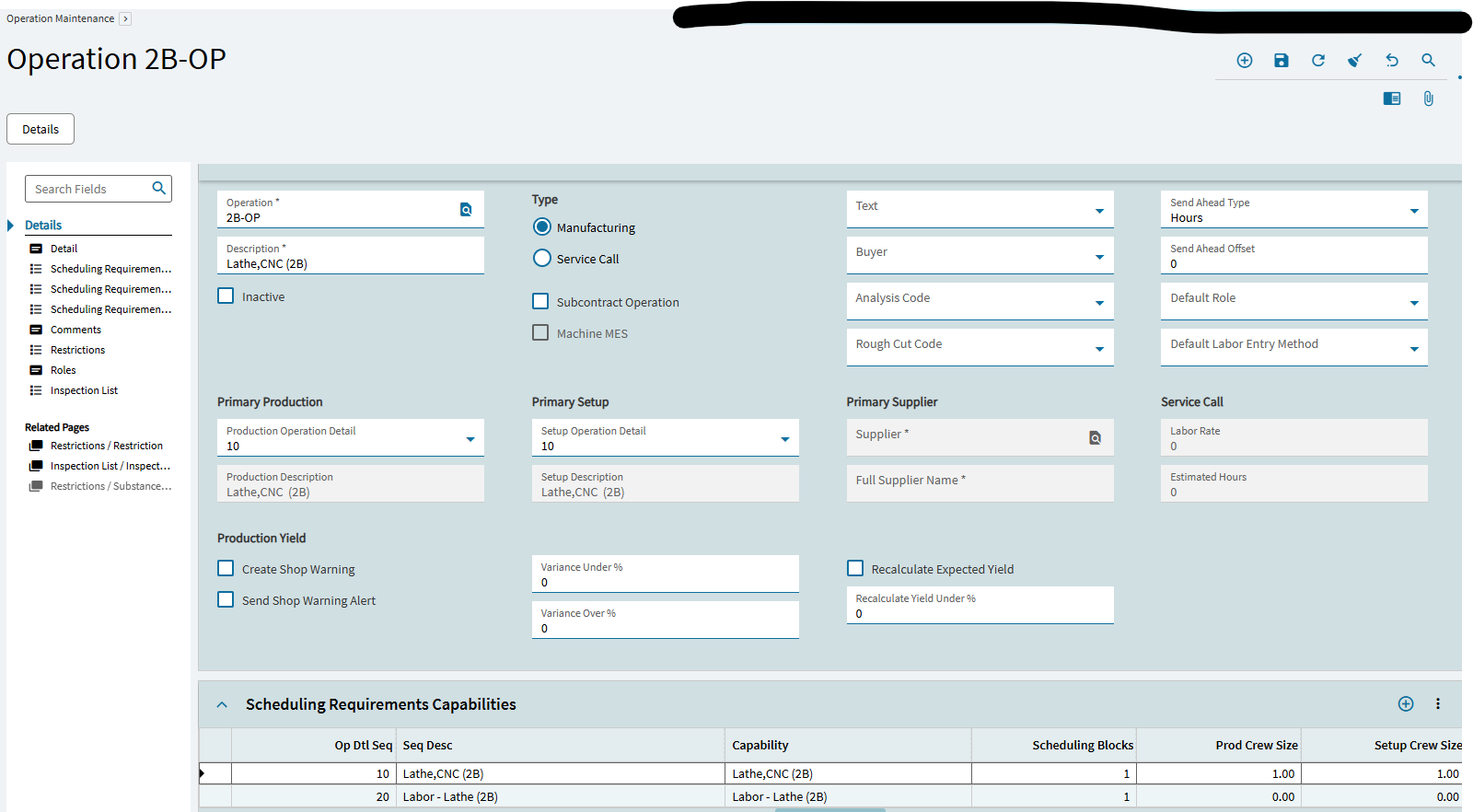

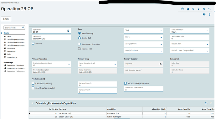

We use capabilities to define which physical resources can be included as part of the capability. We don’t have operation standards in this case.
Here you can see our operation with the assigned capabilities.
I hope this helps!
