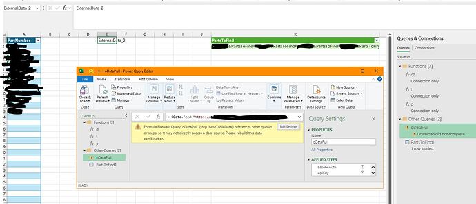

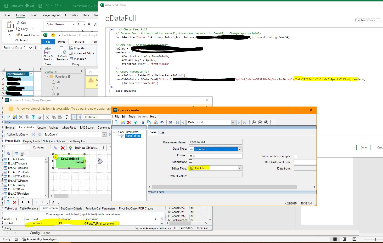

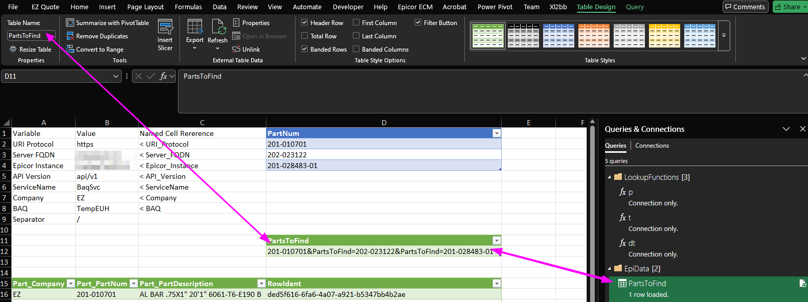

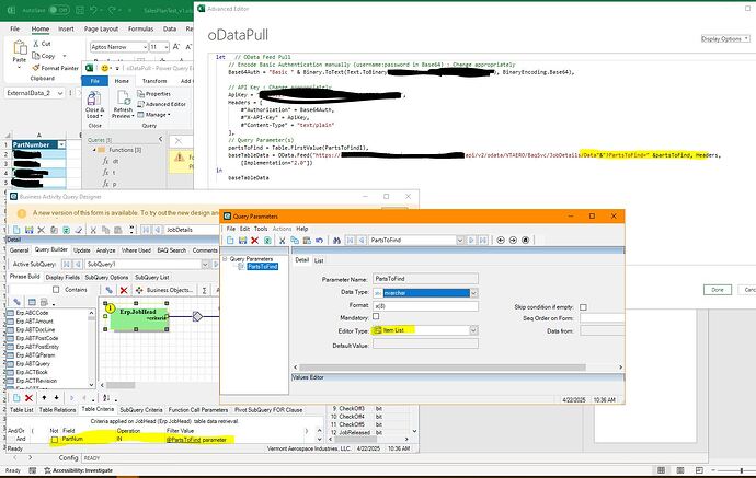

Ok the tPartsToFind is your input table
PartsToFind is the created one liner (Table from Query and named the same on mine) for the OData parameter LIST.
I can get the odata to pull if I remove the parameter:
    baseTableData = OData.Feed("https://MYSERVER/api/v2/odata/VTAERO/BaqSvc/JobDetails/Data?", Headers, [Implementation="2.0"])
But If I add in the parameter segment at the end I get an errror:
    baseTableData = OData.Feed("https://MYSERVER/api/v2/odata/VTAERO/BaqSvc/JobDetails/Data?/"&"?PartsToFind=" &partsToFind, Headers, [Implementation="2.0"])
Error: Formula.Firewall: Query ‘oDataPull’ (step ‘baseTableData’) references other queries or steps, so it may not directly access a data source. Please rebuild this data combination.

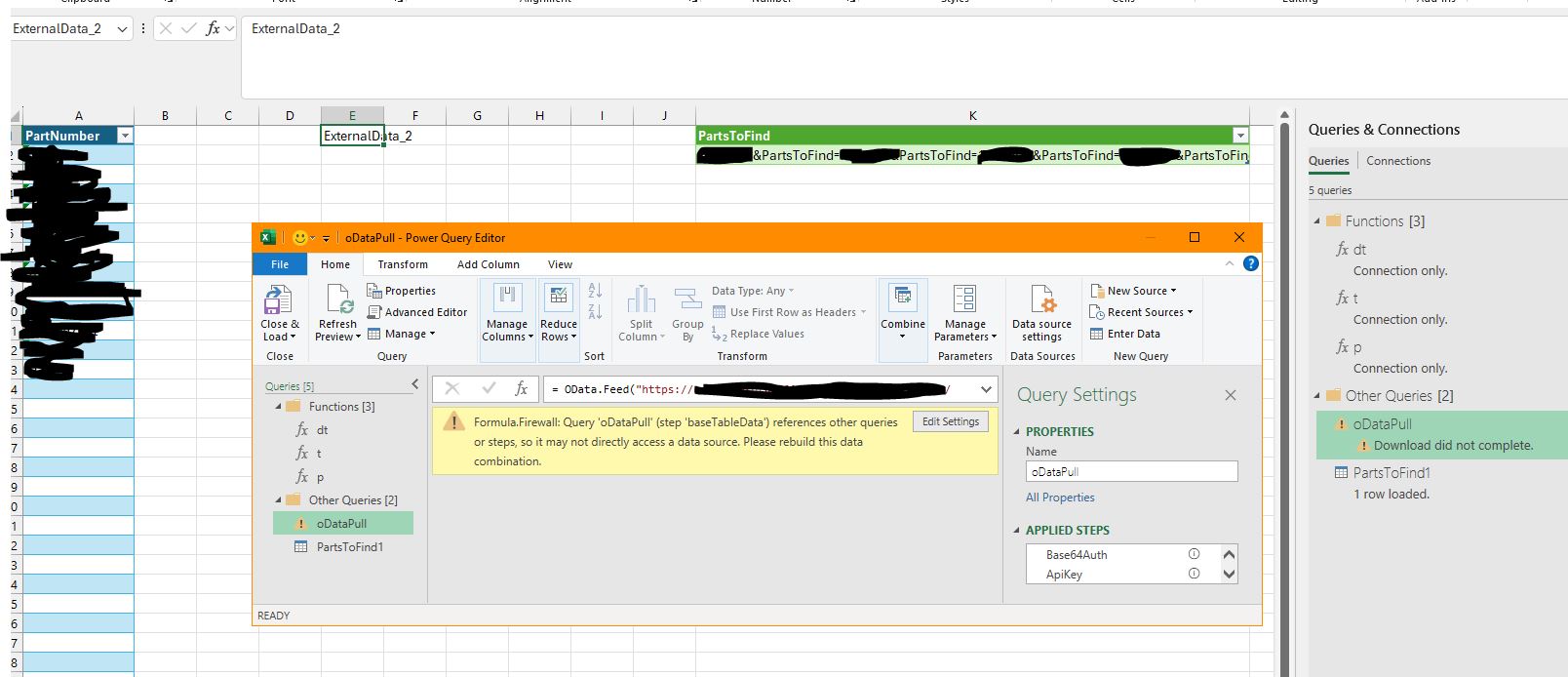

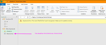

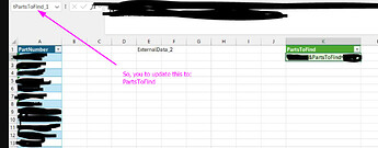

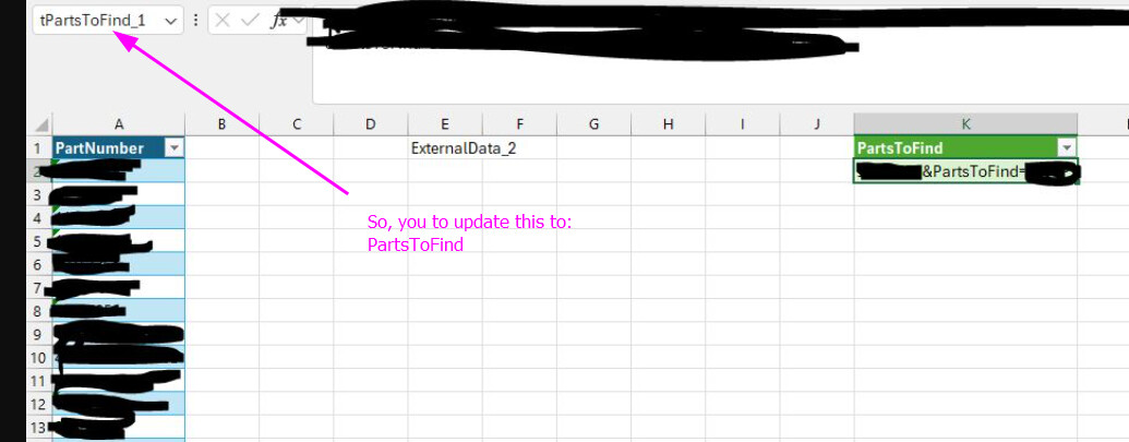

I think I got it all right. I changed the name to PartsToFind1, and updated it throughout. Still getting that error when I apply the parameter. It looks like I have the BAQ and parameter correct.
NVM so is mine…

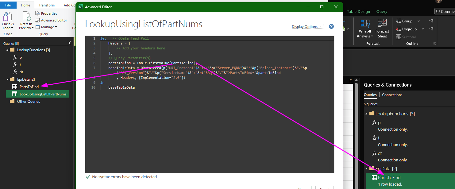

I think this might fix you up. Combine them.
Try:

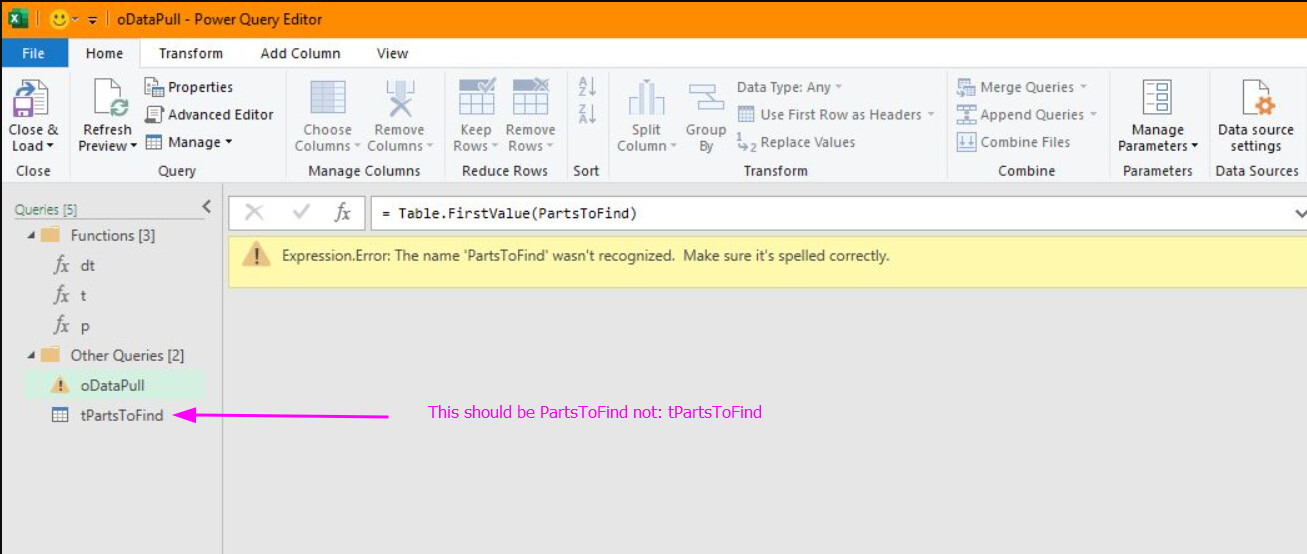

Glad to help I guess it was just mad and felt like it was pulling data after data and did not like that here is what led me to combine it.
Behind the scenes of the Data Privacy Firewall - Power Query | Microsoft Learn
