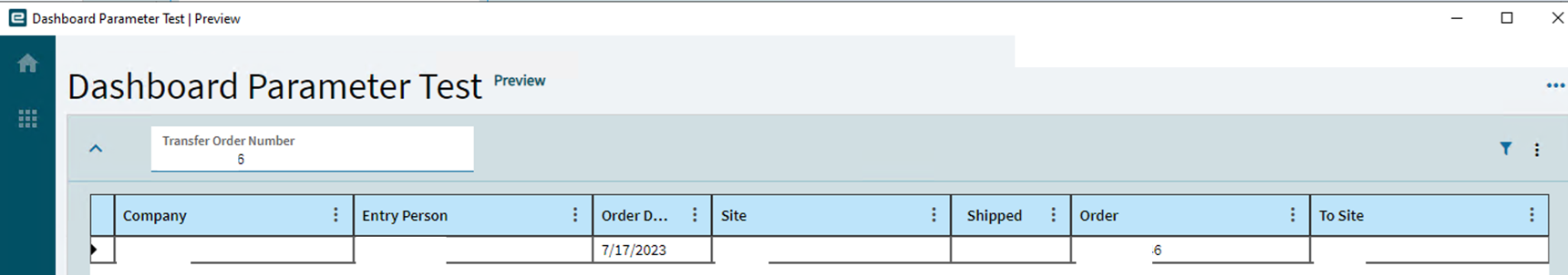

Here is an example of using a filter on a dashboard (without a search, just typing a value into the field). From what I understand, parameters don’t work, or are fairly buggy. So the approach is having no parameters in the BAQ, and then filtering in the dashboard instead.

Preview, and the dashboard should filter as you tab out of the field. I’ve deleted out the data, but you get the idea.
