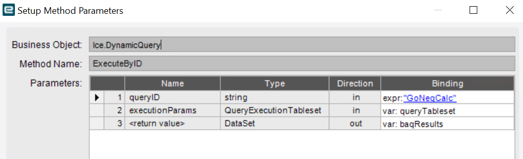

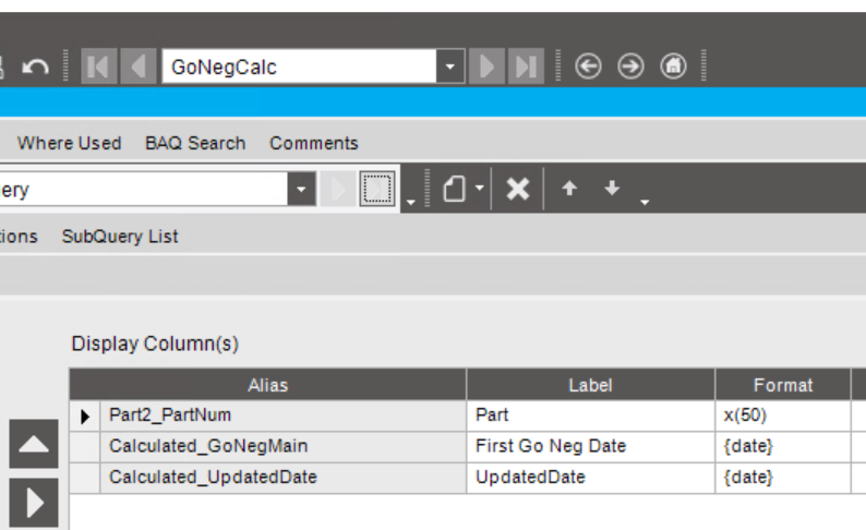

I’m learning to use Functions for the first time and can’t quite get it to work. I have a BAQ that calculates the first Go Negative Date (mirrors the time phase). It’s huge and takes too long to run in a dashboard so I want to take the information and populate it into Part UD Fields (GoNegDate & GoNegUpdated).
My Function runs without errors but the Part Table isn’t being updated. I have function DB Access from Code set to Read/Write and the Updateable box checked on my Part table reference.
BAQ:
Invoke Ice.DynamicQuery.ExecuteByID then run custom code:
