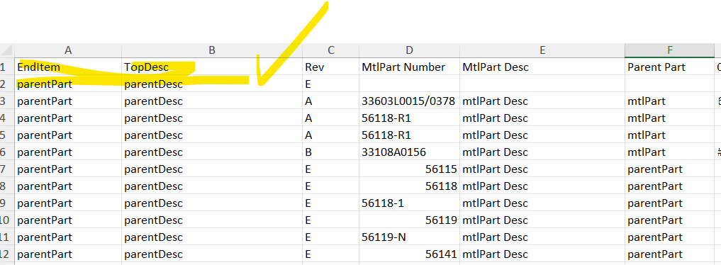

The challenge is-I also need is the parent part to show up just once in the results as a single
row so that I can properly do some ‘stuff’ downstream. I have tried a bunch of stuff as far as a second union between the first union and the top level, I understand how the display columns must match, etc. I believe I am just missing a concept here , maybe it can’t be done in just 1 BAQ. Example parent part: 566-1R , we have 10 total material parts when we dig thru all levels.
 In the example shown I'd like that parent part row to be present.as highlighted. I know how to setup another UnionAll but I think I am not placing it correctly. Part numbers masked here.mostly..

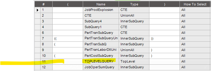

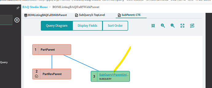

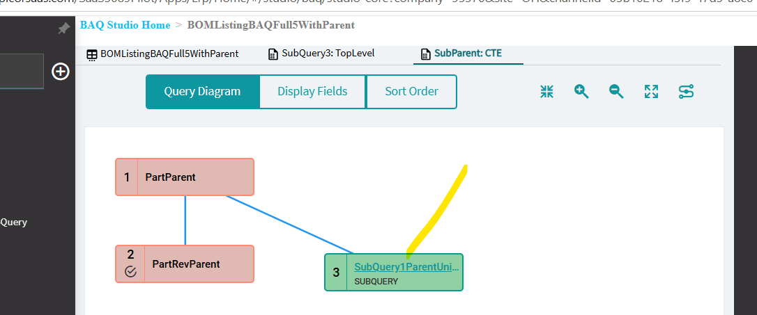

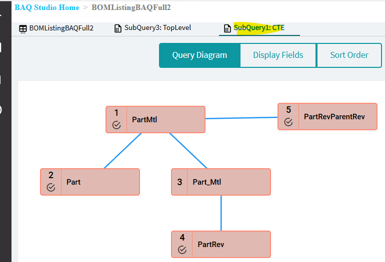

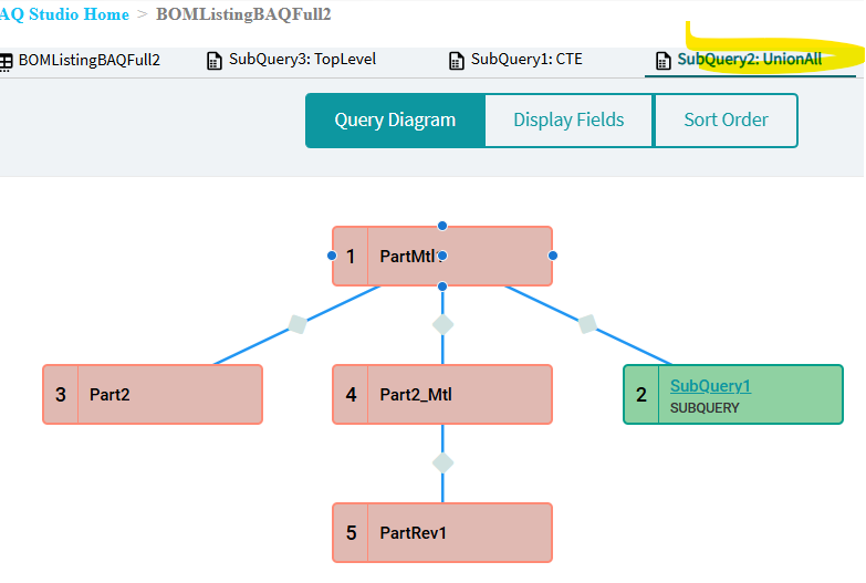

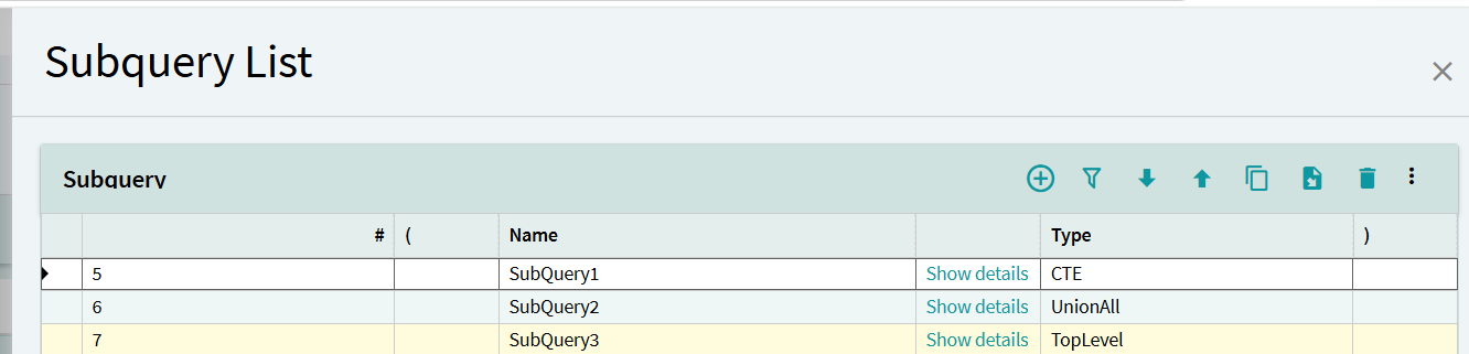

Thanks Brandon, I was only allowed one ‘graphic’ as I just re-joined. Subquery set up, fairly typical I think, at least for a ‘bill of material’ recursive: I think I need to get another ‘union’ that joins Part table to the sub 1 CTE, something like this: but I’m not sure where to put it in the Subs List? I’ve tried after the first Union, before top level, does not work there. My apologies, I realize I’m explaining this very well. ONly 1 graphic allowed so this is the other ‘union all’ I want to get into my subs list
Top to bottom, subs list:
Sub1 CTE
Sub2 UnionAll
Sub 3 top level
Subs arrangement currently:

sub 1 CTE
sub 2 UnionAll
sub 3 TopLevel
Thanks Haso, so in your example, all UNions, etc need to be Before the Top level ?
