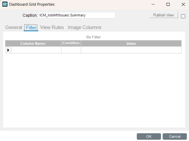

Are you looking to filter at the Top Level (first query line in tree) or the Summary Properties (bottom line in the query tree)? The latter opens the Dashboard Grid Properties window. I’ve had better luck there with setting up the filters. You can check for your fields there as well.
filter on query > dashboard > properties …
