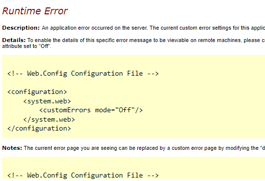

Thanks I tried the following…
“whereClauseJobOpDtl”: “JobNum = ‘J047961’ AND AssemblySeq = 0 AND OprSeq = 100”,
“pageSize”: 0,
“absolutePage”: 0
But I get a .net error message back. Did I miss something?

I tried…
"whereClauseJobHead": "JobNum = 'J047961'",
"whereClauseJobAsmbl": "AssemblySeq = 0",
"whereClauseJobOper": "OprSeq = 100",
"pageSize": 0,
"absolutePage": 0
And I still got the .net error. I can get the data I need from GetById but it seems like overkill and I’m going to have to filter JobOper down to the current assembly and operation I need.
You have those fancy quotes in there? ‘’ instead of '' ?
