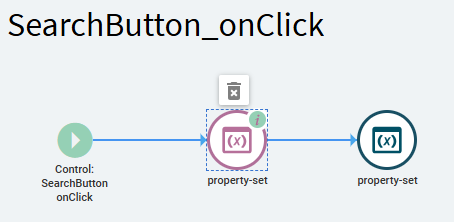

I think you have to change the property for the stack as well as the individual grids in the stack. When changing the “expand at runtime” property, I have to do it for the stack as well as the grids so it’s probably the same for button events.

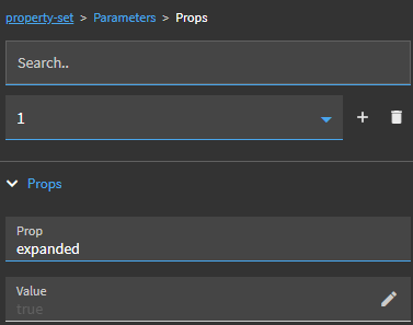

Do you mean like adding a second property-set to the onClick like below?
It didn’t work for me.
Yes, one for the stack and one for each of the grids. I tried and it didn’t work for me either. I tried different orders too: (stack, grid, grid) and (grid, grid, stack). You could try expanding the stack in the button onClick event and create a separate event to expand the grids. Or vice versa. You never know … App Studio is quirky :crossed_fingers:
