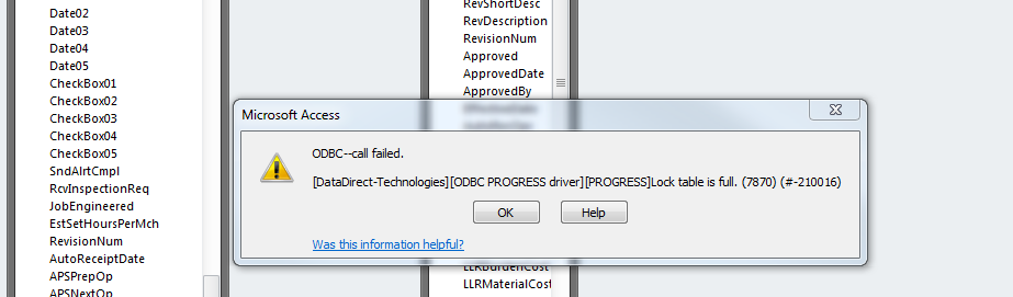

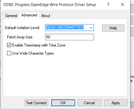

# Vantage 6.1 - Progress 9.1 | ODBC Call Failed **Category:** [Vista/Vantage 8](https://www.epiusers.help/c/vantage-8/8) **Created:** 2016-10-28 19:04 UTC **Views:** 974 **Replies:** 3 **URL:** https://www.epiusers.help/t/vantage-6-1-progress-9-1-odbc-call-failed/36001 --- ## Post #1 by @tse.dba I have run into a few issues while running queries in Access via ODBC connection. I would get an ODBC call failed on certain queries. One Example, when I add criteria to one query, i get this message. If i remove the criteria, it works. It is not always the criteria that causes the issue, it can be other random things that causes it. Any Ideas? --- ## Post #2 by @TGCTSE Make sure your ODBC Settings Advanced Tab->Isolation Level, is set to READ UNCOMMITTED --- ## Post #3 by @tse.dba That did it! Thanks!! --- ## Post #4 by @Neil You should mark this as solved. Neil --- **Canonical:** https://www.epiusers.help/t/vantage-6-1-progress-9-1-odbc-call-failed/36001 **Original content:** https://www.epiusers.help/t/vantage-6-1-progress-9-1-odbc-call-failed/36001
