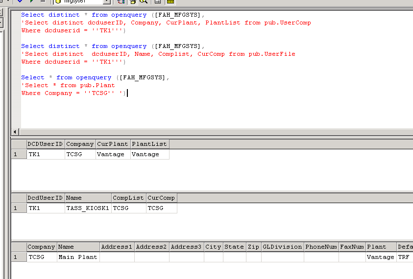

That is what I was thinking too. I checked their log in and an a plant is assigned. I tried it with mine and a got the same error. I have a plant assigned too.
I got it fixed. I had to log in Vatnage and go to the user account and remove the plant and save then add it back. I think I know what corrupted the files but at least now I know if I remove the Pant and readd it seem to fix the issue.
