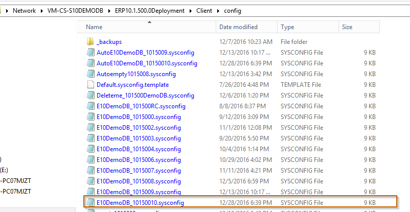

## Post #10 by @aidacra
Screenshot didn't make it through, but you could try this:
1. On your RDS server, right-click on your Epicor shortcut and select Open File Location.
2. Open your Config Folder.
3. Open the appserver .sysconfig file in a text editor.
4. Search for **deploymentserver**.
5. Close the .sysconfig file.
6. In another Windows Explorer, navigate to the **[deploymentserver]\client\config**.
7. Copy the .sysconfig file with the same name as step 3 and overwrite the one in the RDS server's client folder
8. Open the newly copied .sysconfig file that is on your RDS server with a text editor.
9. Search for customization name and remove the reference to the latest patch.
BEFORE:
AFTER:
10. Save your changes.
11. Launch your client shortcut on the RDS server and hopefully the autoupdate triggers successfully.
