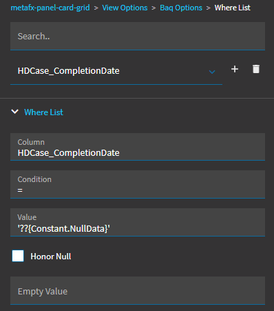

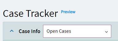

I’m new to Kinetic UX. I’m trying to figure out why the “View Options” (Open/Closed Cases) isn’t working. I converted from the classic dashboard to the Kinetic App. Everything else works fine except for this view option using the top combo box. What am I missing?

Try double quotes:
“??{Constant.NullData}”
Hope it works
Thanks, Jordie.
Unfortunately, it didn’t work with either single or double quotes.
I had never encountered the Constant dataview before … but maybe it should be Constant.NullValue?
Good question here. Trying out now, but nullable dates seems to be a pain in the ass

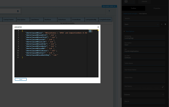

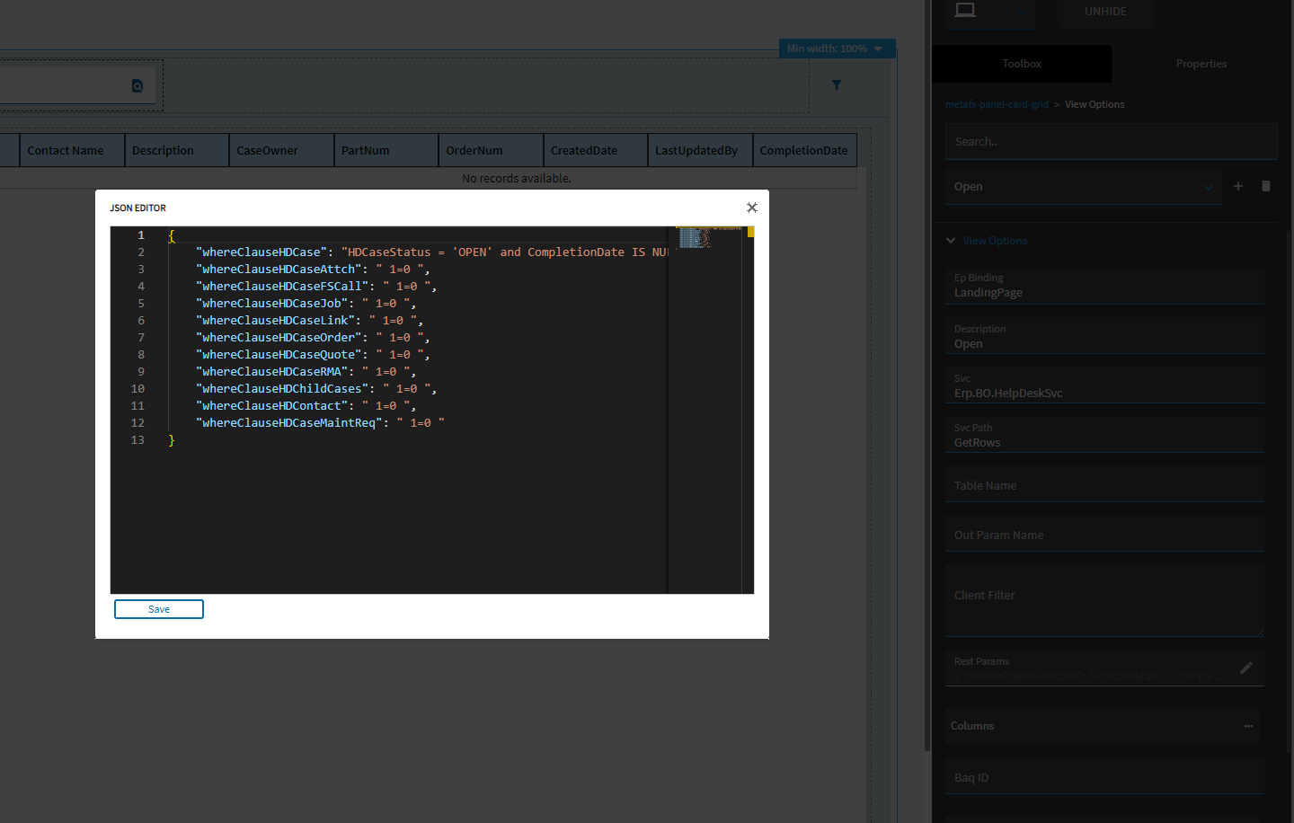

Does this help:
“whereClauseHDCase”: “HDCaseStatus = ‘OPEN’ and CompletionDate IS NULL by HDCaseNum DESC”
btw this is option “Rest Params”
If this is a rest call to Erp.BO.HelpDeskSvc then the BAQ Options will not do anything at all. In which case, the Rest Params is the best option.
Epicor rarely stores data as NULL … but I just confirmed that an empty CompletionDate in this table is stored as null. In your BAQ Where List, then the operator is IS NULL (with nothing in the Value field) instead of =

Try the IS NULL operator.
NULL does not equal the empty string and Where List uses pseudo SQL in its comparison

I had to replace the one of the auto-generated conditions in View Options.
  • from : HDCase_CompletionDate = ‘??{Constant.NullDate}’
  • to : Calculated_Status = ‘Open’
