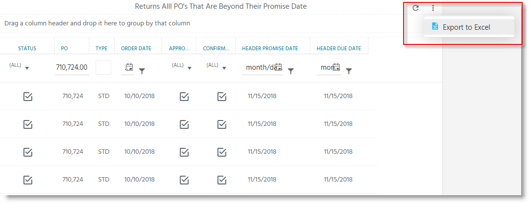

It can be done with a BAQ Grid Tile. Click the top right 3 dots icon. I don’t see a way to do this with a chart view or KPI view.
@mhelfrey, I presume you are referring to exporting in general. Is that right? I want to view or export the records in the HomeTile table specifically, but I haven’t found any way to do that with either Epicor tools or even SSMS.
I don’t think you can view or export the records in a standard EDD Tile. What I am showing is a BAQ that I made and added it to the EDD Home Page, I can export records to Excel from this.

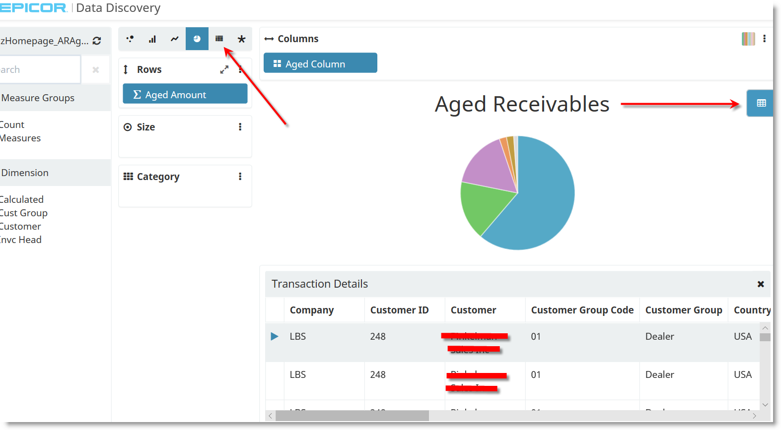

To see the data inside of an Epicor created tile, you would have to edit this in the EDD website and click on the table view or transaction details buttons.
Here I have clicked the transaction details for the Epicor Aged Receivables Tile. Even then, I cannot export this data from here.
I think I would have to copy the standard BAQ to my own to get at the raw data.
