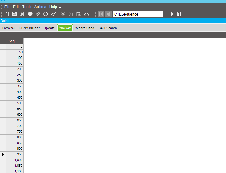

You can use a recursive CTE and not waste a single table… (maybe) stab in the dark.
CTESequence.baq (17.4 KB)
I went with the UDCodes Thanks for the reminder Monty.
