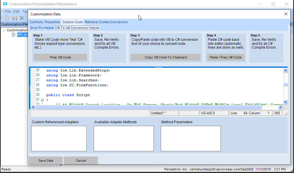

In Customization Maintenance, there is a helper tool. It’s not perfect but it might help you out a bit. Click on View Customization under the Action Menu and go to the Custom Code Tab.
sweet that’s cool! thank you
You could always throw a hook out on the forum to get someone to convert everything over for you. As mentioned, the converters get you close, but not quite.
Online converter and the Customization Maintenance get you 80%. The last bit is tricky for someone new, but minutes for someone experienced. I personally feel it is always worth the conversion and recommend it often.
