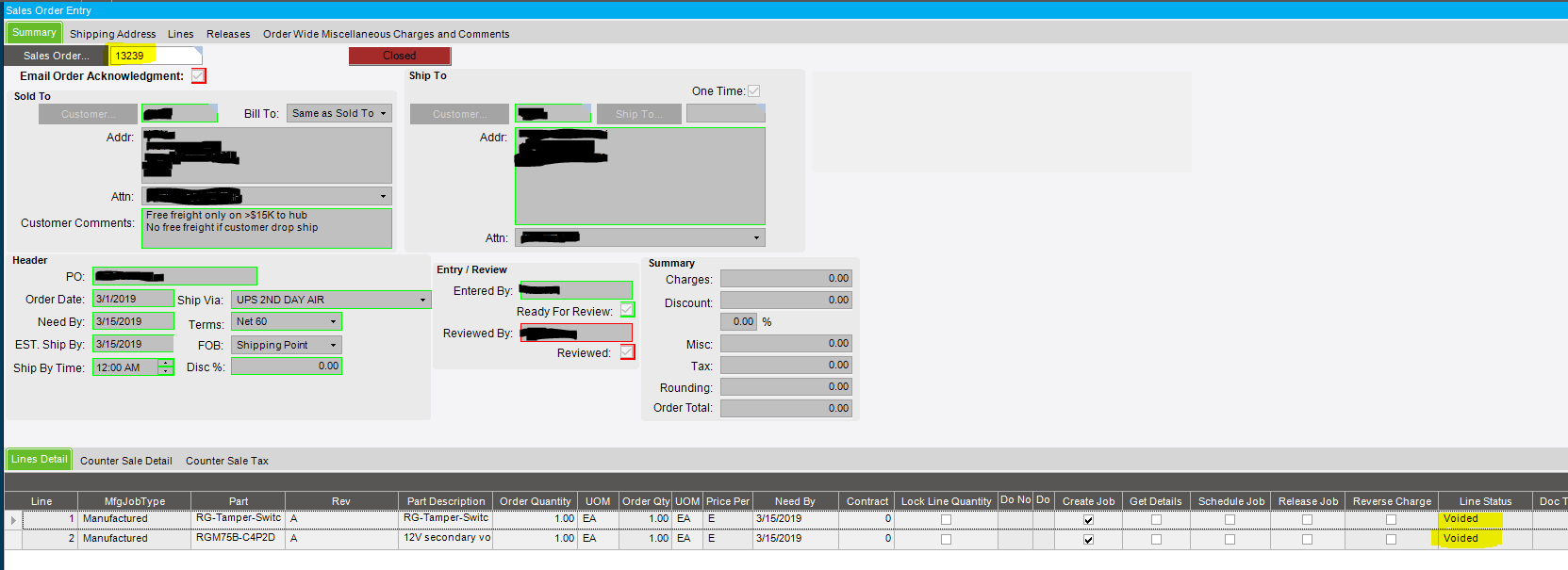

Closing an order before a shipping entry was created would mark it as void correct? If yes then, can someone help me figure out why I’m not able to see that status in DB.
I am probably missing something really stupid but I’m not able to see the same LineStatus for the order when I’m trying to create a dashboard with BAQ. All I see in the Query is “OPEN” for that line, even though in Order Entry it clearly show “Voided”. What am I doing wrong?
So here I see that these lines are voided:

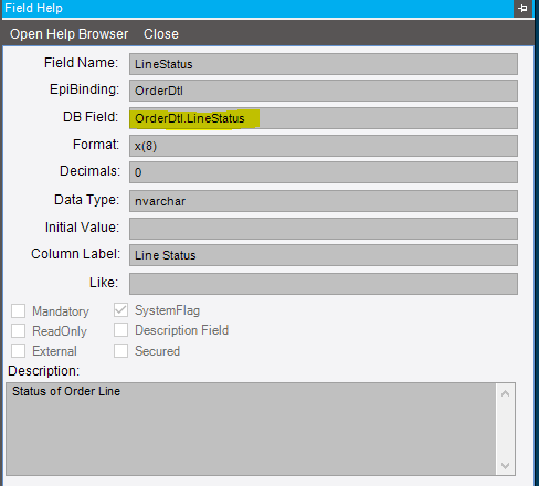

And there is supposed to be a DB Field for it:
DB

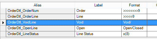

I thought this would let me queue that database field:
setup
However, this is what I see:
baq
Add the field OrderDtl.VoidLine
Use order detail Void Line to see lines that have been closed without shipping.
Thank you so much! I knew I was missing something stupid. Is it normal for those lines to stay open in status eventhough they are void? Do I need to do another step to complete the cancellation of an order, other than closing it?
I believe that is normal - the underlying status does get a little confusing.
