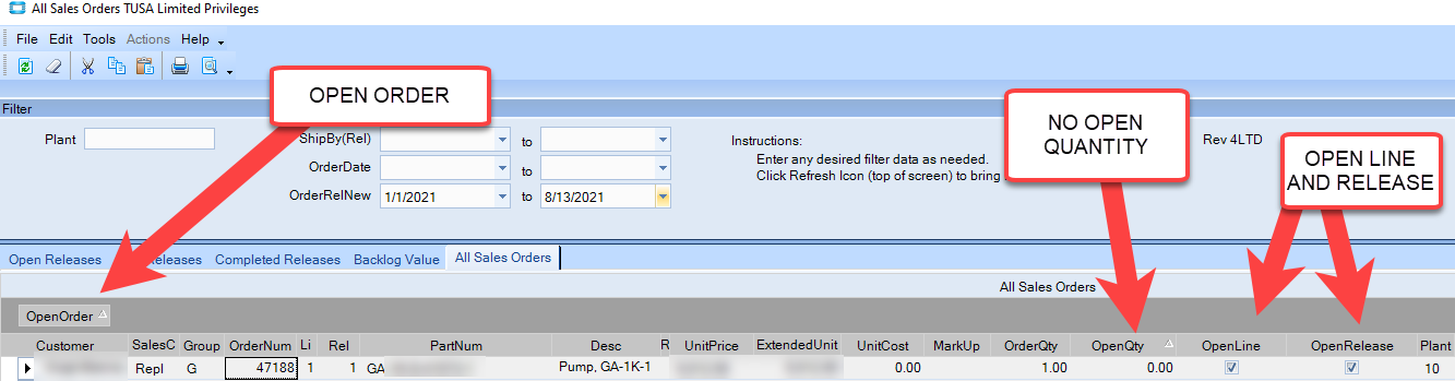

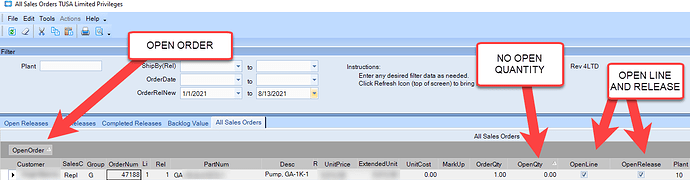

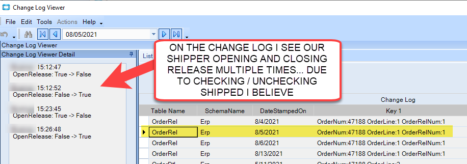

Just an FYI, we sometimes have “dangling” open order releases due to shipping personnel checking and unchecking shipped and complete multiple times. This dashboard below that I made for summary view of sales orders shows an example. I thought you might want to be aware of this possibility as well. One last thing, on the order line and release, it shows quantity shipped, which could be useful.
