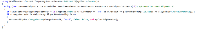

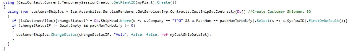

I got it to work Async with the following:
