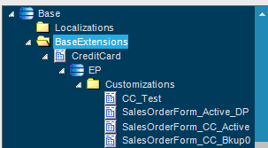

When I select a Customization that has a BaseExtension Visual Studio opens up both and sets a breakpoint in both layers automatically. (10.2.400) it shows up as 2 tabs in Visual Studio (2 files)
