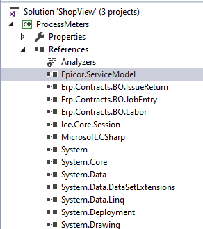

An old program was designed by a person no longer with us, in VS 2019. It is writing to laborDtl using the BO.
We added a new field to write to CommAssig_c.
We are unsure how to add this new field into the VS app. In my long ago use of VS (2010) there were a xsd file containing all the TableAdapters , I would just delete and readded the table.
But here I do not see that. So I am unsure how to do it. I saw some autogenerated code pertaining to the fields available to write to, but I am unsure how to regenerate it.
If it is an external application, I assume he was utilizing the WCF web services. These would need to be re-imported after a schema change.
I don’t have a WCF app readily available, but to reimport your references you do should be able to go to the web references folder, right click on the LaborDtlSvc, and click Update Web Reference.

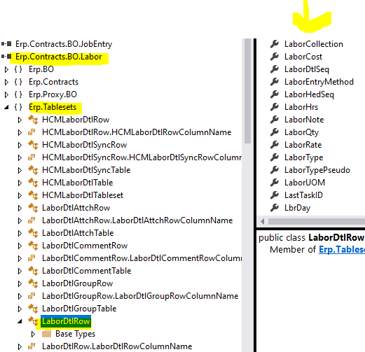

That’s the class within the BO it will never know about your UD field. It will only know about Native fields. I’m not sure if you can maybe use the .UDField method from there like in BPM land but I’m not sure.
