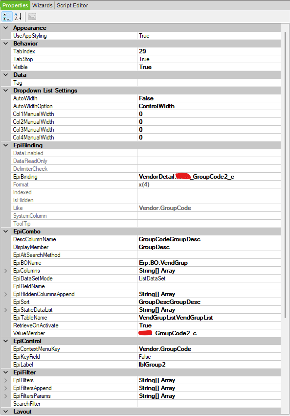

Hello,
I thought I had this beat but I am getting the same value showing in all three group boxes.
The actual values in the 2 new group epicombo boxes is correct (I have them set to different values and checked with BAQ), it is just showing the original group (Group 1) box value on the Supplier screen.
Any idea on which value to change in customization to get it to reflect the actual saved value for each box?

The VendorDetail view is the Epicor created one.
I am not sure how to reuse the Vendor.GroupCode dropdown list on my new boxes. This approach doesn’t seem to be working for me.

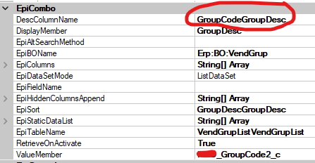

Pretty sure this is your problem.
I built this real quick in Kinetic and I don’t have the UD fields set up so I’m just using TransView…
But it holds the value of GroupCode2 and GroupCode3.
But since “GroupCodeGroupDesc” is used in all (3) of my combo boxes, it is being overwritten with the last value selected.
In the test below, i set GroupCode3 and then went back and changed GroupCode2:
If I change those to GroupCodeGroupDesc2 & GroupCodeGroupDesc3 (respectively) and retest… I now get this:
I see them both.
Now, I’m using TransView so it may be auto-generating those and adding them to TransView. You’ll have to test it and see if it will work in your case or not.
