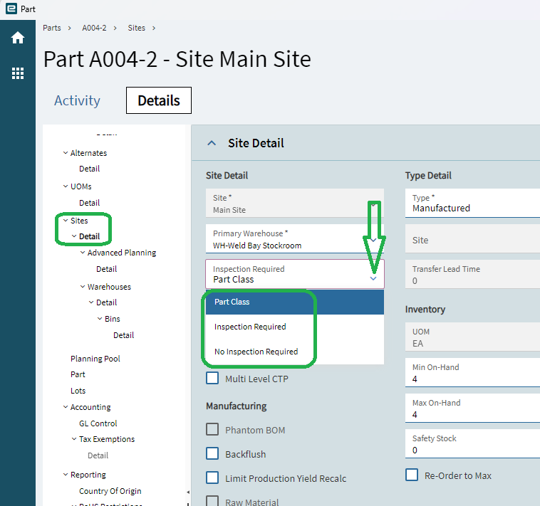

Way to go Epicor! Another Kinetic Idea implemented, Individual Part Inspections!
Long awaited, individual Part Inspection Required functionality.
Took me a bit to find it in the new release 2023.2.3
Thank you for not putting it in the Advanced Quality Module requirements.
Under Site/Detail on Part.
The new box “Inspection Required” defaults to “Part Class” but can use Drop-Down to select “Inspection Required” and “No Inspection Required”.
I will test it thoroughly, but I like the implementation already! (Thanks Tim S.)
