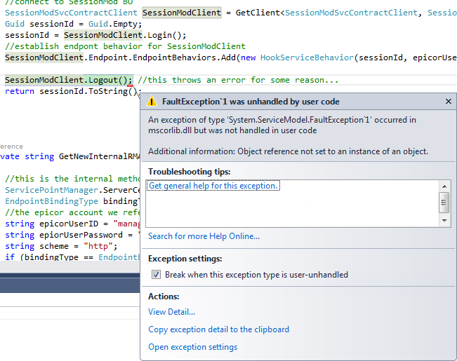

Going through the old WCF documentation and I’ve run into a snag with the SessionMod client behavior.
I am able to login to the session, but when I call the logout method, I return an error:
This seems strange especially since it’s coming straight from the documentation. Anything obvious jump out at you as to what the issue might be?
it is error in the guide
you need to recreate SessionModClient proxy after call to the Login:
sessionId = sessionModClient.Login();
Something like this:
// now we need to create a new instance of the SessionModSvc client class before we can apply the
// Endpointbehavior to it, otherwise it will not pick up the new behavior.
builder.Path = instance + “/Ice/Lib/SessionMod.svc”;
sessionModClient = GetClient<SessionModSvcContractClient, SessionModSvcContract>(
builder.Uri.ToString(),
epicorUserID,
epiorUserPassword,
bindingType);
Otherwise behavior you add later is not applied. And no SessionID is sent to server for Logout
The code is already in the guide, it’s step 7 on page 15. It is missing from the full method code provided on page 18.
Olga is correct - we found that some time ago and I thought fixed it. I’ll circle around on current documentation - I could swear we fixed that but I may be off in my versions.

Thanks. It’s not very obvious in the guide, but I see it now that you’ve pointed it out.
It’s fixed in the documentation, although not very visible. I also had older documentation, so that probably helps to explain it.
