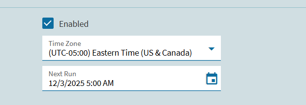

Here’s a screenshot from a task in our agent…try changing to uppercase AM with no dots and saving the task.

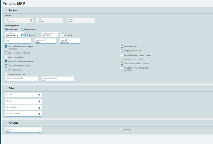

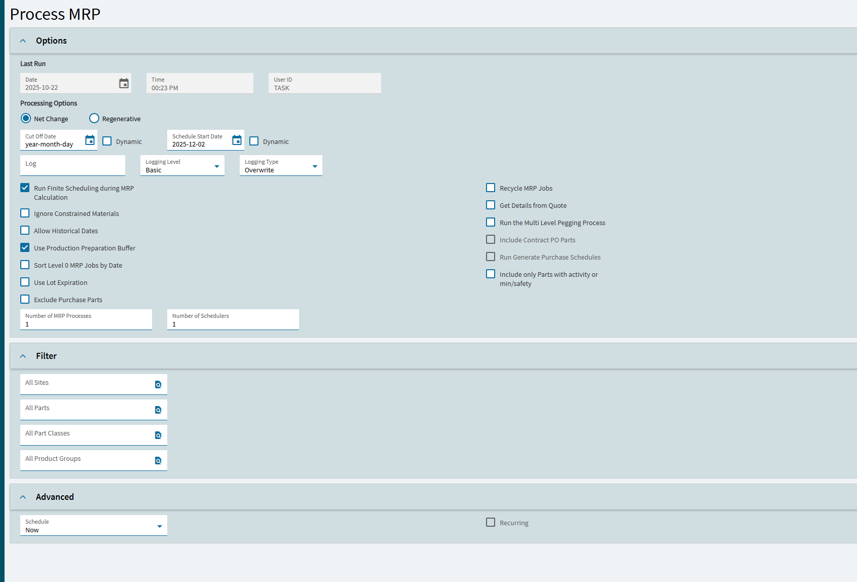

The process is not running on a schedule for the test that I’m doing. I’m using the Schedule = ‘Now’ like this:
OK, so not running on scheduler…just a realtime run (with recurring not checked) and then clicking the gear icon to submit. Seems odd. I don’t think we fill in a cutoff date on ours but you might want to try one.

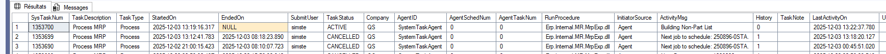

I just finished my 3 tests (Well 2 are finished but the other one I see what I needed to see)
1st Row: English (United States)
2nd Row: Invariant Language
3rd Row: English (Canada)
Both row 2 and 3 are stuck at the job scheduling and it takes hours until I have to force the row to be cancelled via the database
The 1st row, however, finished the scheduling subprocess and is now processing the parts. Not sure if someone else can do a test but it seems like the MRP job scheduling is not working in other format culture following the update (2025.2.5)
