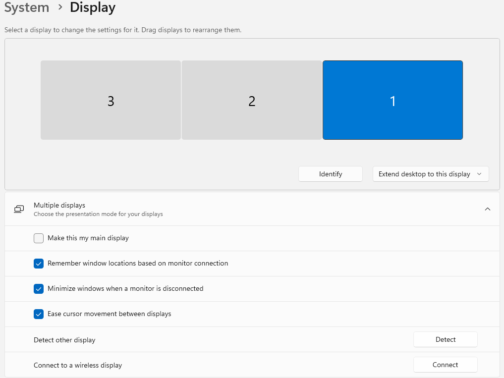

Doesn’t windows handle this? Windows opens apps wherever they were last closed from.

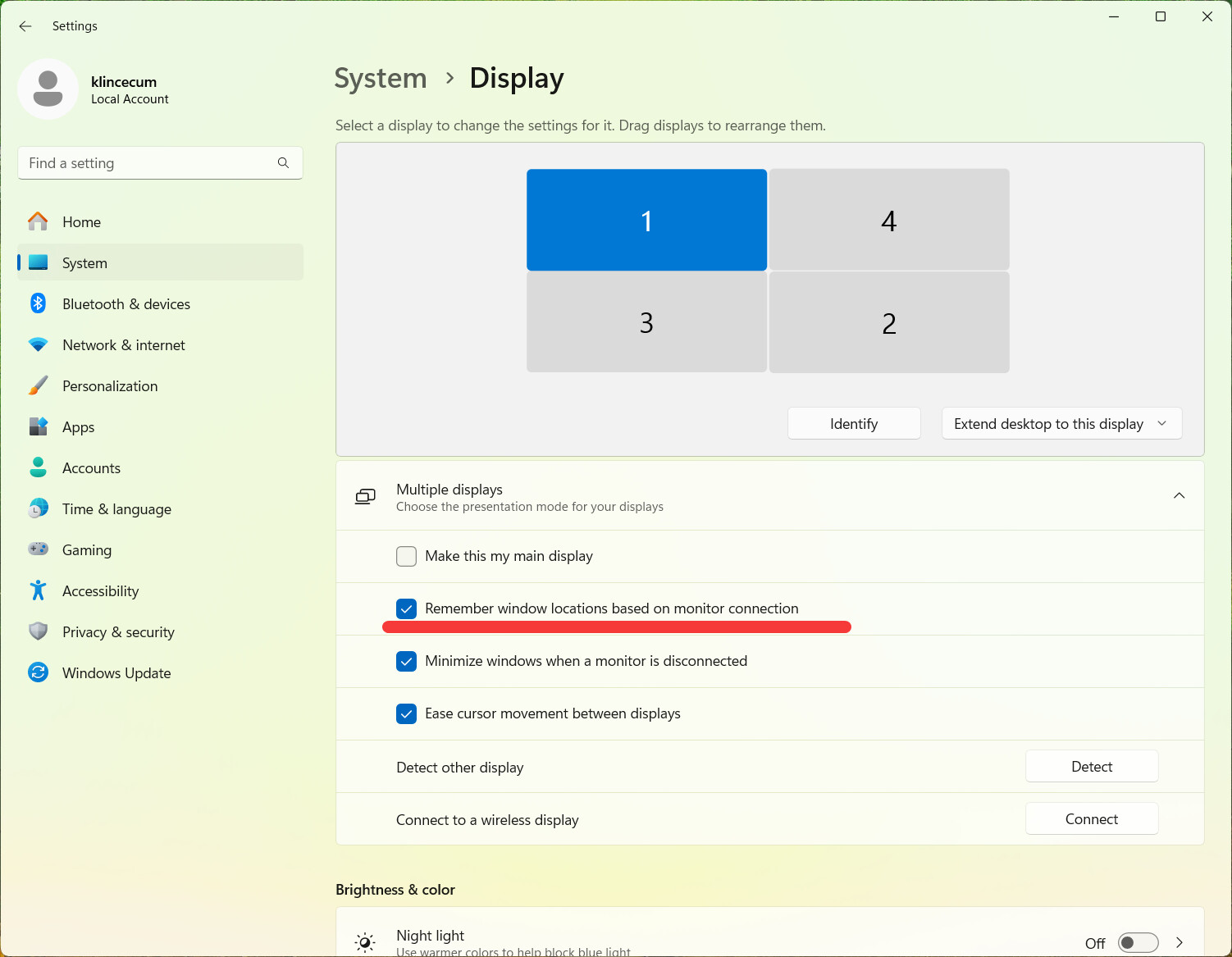

Hello,
I tried it both ways on mine and it always opens on the first screen for me.

Mine looks the same as yours but the screen doesn’t follow what windows says for me.
Try unchecking, and rechecking and reboot.
