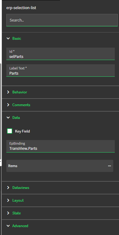

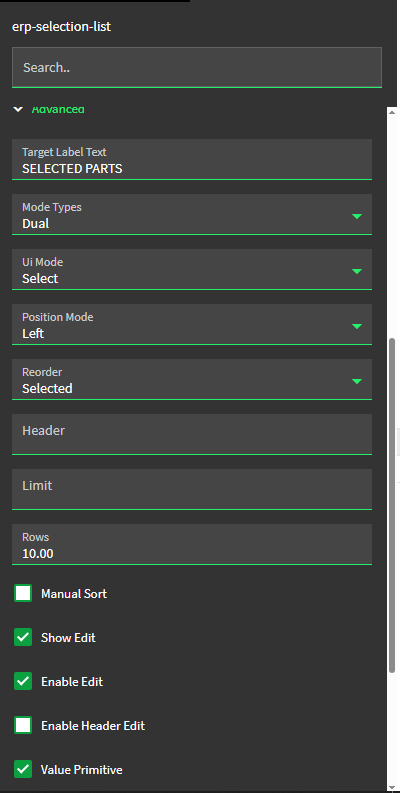

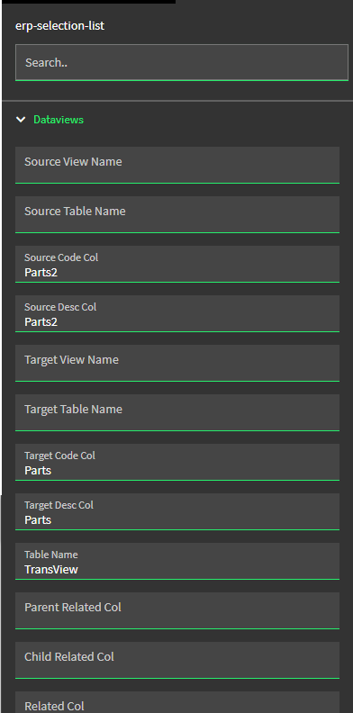

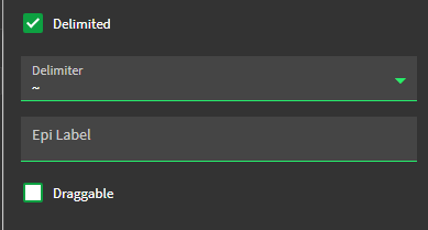

here’s a working tilde field to tilde field (#2) setup (notice TableName is required):
