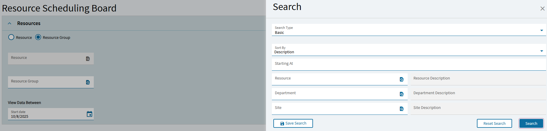

What event is this?
I am looking for the event that calls this search box on the loading of the form. I have checked almost all events and cannot find out how this screen is calling this search.
I am trying to remove needless clicks, and one of them is searching for a resource group. I have it auto-filling in the resource group, but this search slideout is still coming up by default.
I have tried form_onload, and that is not it.

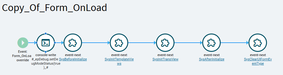

Hi, Form_OnLoad is indeed the (parent) event that calls a (child) event that pops up the search-show. In app studio, if you create a new layer on resource scheduling board, then in events, right click Form_OnLoad, copy the event. change the trigger on the copied event to override the Form_OnLoad event, as such:
Then, insert a new console-write action at the beginning of the event chain:
containing the text:
#_epDebug.setDebugModeStatus(true)_#
This will enable debugging as early as possible, which allows you to see the event chain in early load.
Form_OnLoad → SysAfterInitialize → AfterInitialize → KeyFields.ResourceGroupID → search-show

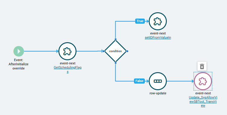

Here is exactly what I did for anyone who might have this problem in the future.
I copyed two events Form_OnLoad & AfterInitialize.
At the end of the Form_Onload I added a row update for KeyFields.ResourceGroupID.
AfterInitialize I changed the last event on the condition false side to Update_SysAllowViewSBTool_TransView
Both are set to override base.
