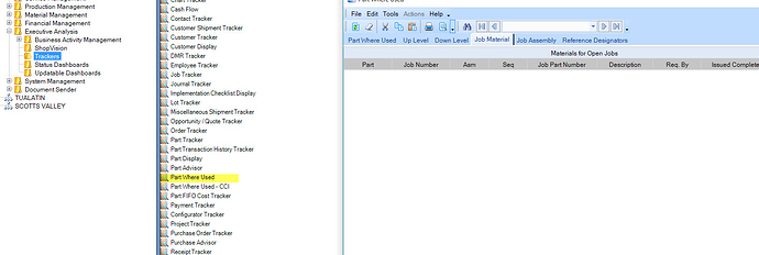

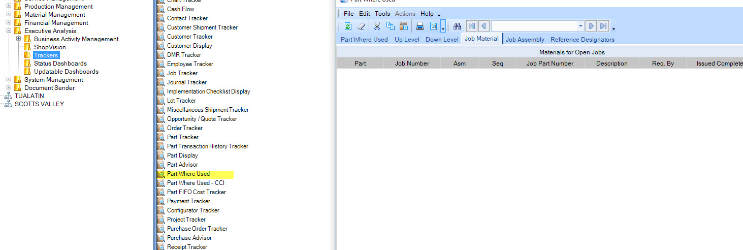

You should be able to write a query/report to mimic the where used function
for jobs materials.
Brad
This doesnt help you?
We might be able to use the Part where Used, but we were hoping to make it visual for the workers on the floor that don’t have access to certain Epicor screens. Thank you for the suggestions.

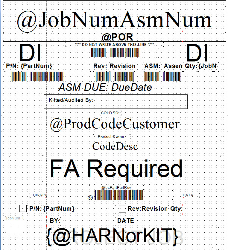

We do a lot with our JobPickList which was merge with our JobTraveler…
i would put come type of checkbox on Part Entry on Part4, and when Part 4 is listed on my Job Picklist, I would bold, Italicize and shadow the PN. What do you do now to notify them?
Miguel,
Thank you, I will look into that. This would save a lot of people from having to track it manually. Currently we don’t notify the people on the floor, usually someone in engineering will follow the old WO and new WO out on the floor to verify everything is being processed correctly.
