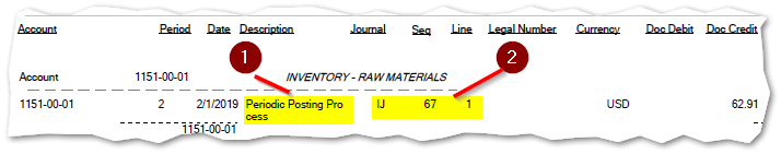

Inventory movements get summarized and posted as “Periodic Posting Process” when you run the Capture COS/WIP process.
If you have the JE Number for one of those, you can enter it in the WIP/Recon report, to see the details of that GL Tran.
For example, running the GL Report for our inventory acct shows:

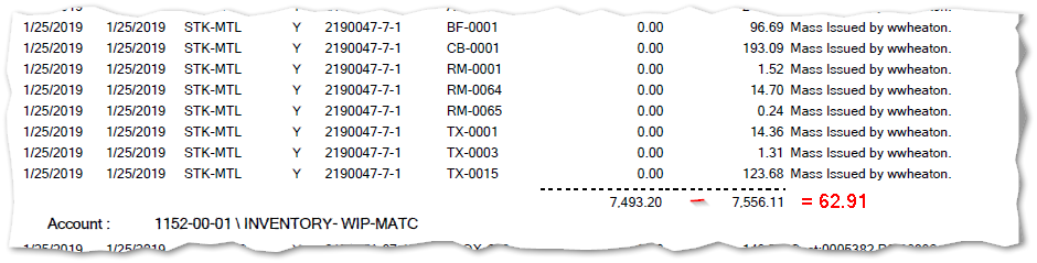

Running the WIP Recon report with the Journal Code and Num set to the PPP tran from the GL report:
yields the Part Trans that were in that summarized GL Tran
(the $62.11 in the Wip Recon matches the $62.11 in the GL Report)
