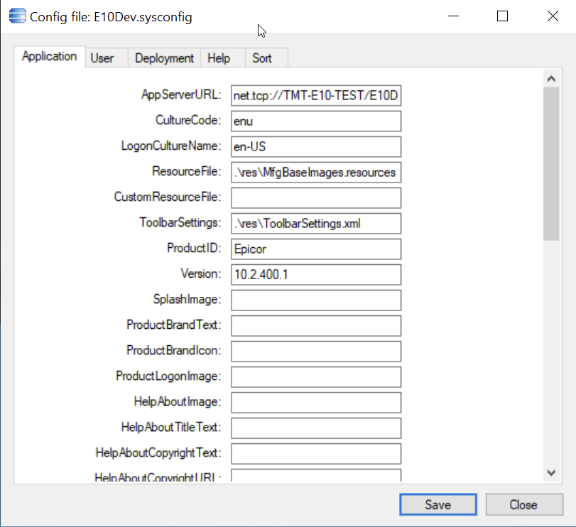

Try editing the sysconfig file with the configEditor (Run ConfigEditor.exe in the Epicor client folder)
This is what ours looks like.
If that is the issue then I expect you will need to check the sysconfig file on the server. The client will take a copy from the server so if the server copy has an issue all the clients will have the issue.
Brett
Thanks @bmanners. Cannot save one i edit the config editor
