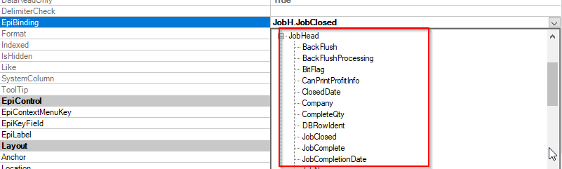

I’m in the ClosingJob form. I dont’ know why but I can’t bind custom field because there not there in the field selection. So I want to add a field and populate it with the custom field via an adapter.
But I don’t know the event trigger to use to populate my field each time I move to another job number?
Just curious, is this a custom field that you just recently added that you are trying to bind to? If so you may need to go to your Administration Console and Regenerate the Data Model for your database in order for it to show up.

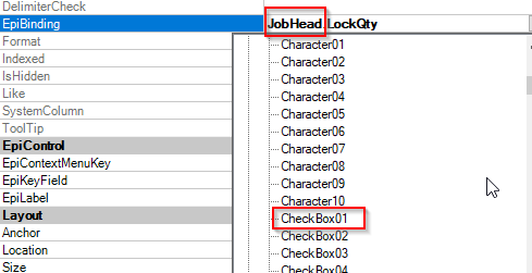

It’s the field CheckBox1 who are in JobHead but in the ClosingJob form the field was’nt present.
My Idea is to add a check box object and populate it each time I change of jobnum.
Can you see that field somewhere else? How do you know it’s there?
Each table have lot of fiels we can use. JobHead have this fields in other form, like the job entry form.
2019-07-17%2010_39_03-Customization%20Tools%20Dialog%20(default)
I don’t know why the ClosingJob form don’t have it. Bu what I’m trying to do it’s find the trigger when I select another job number to populate my field.
I E9 they had those extra fields. In E10, they are not there by default, you add them yourself. If you did an upgrade from E9, some of those fields will come with, but only if there was data in those fields.
