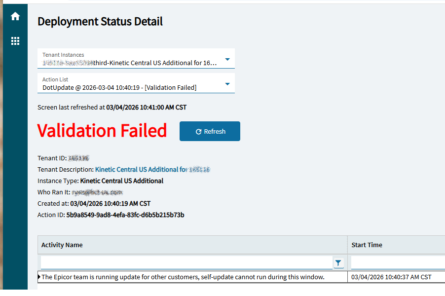

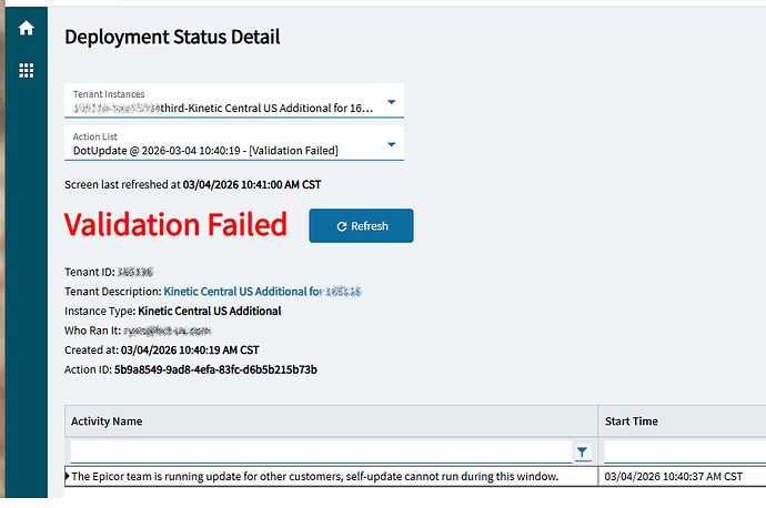

It is very difficult to upgrade early when its not even available in the CMP until today 3/4 AND you aren’t even allowed to upgrade because you are within the 48 hour window of when the cloud team forces it.. for self managed instances. I tried:
Here is their Policy incase you weren’t aware:
Epicor-Cloud-Management-Portal-Policy
My regen is failing and I’m not even set to be upgraded. I’m flex 2.
From talking with support it’s expected that CMP doesn’t let you do stuff during any worldwide maintenance window, we are Flex 2 as well and have encountered the issue multiple times.

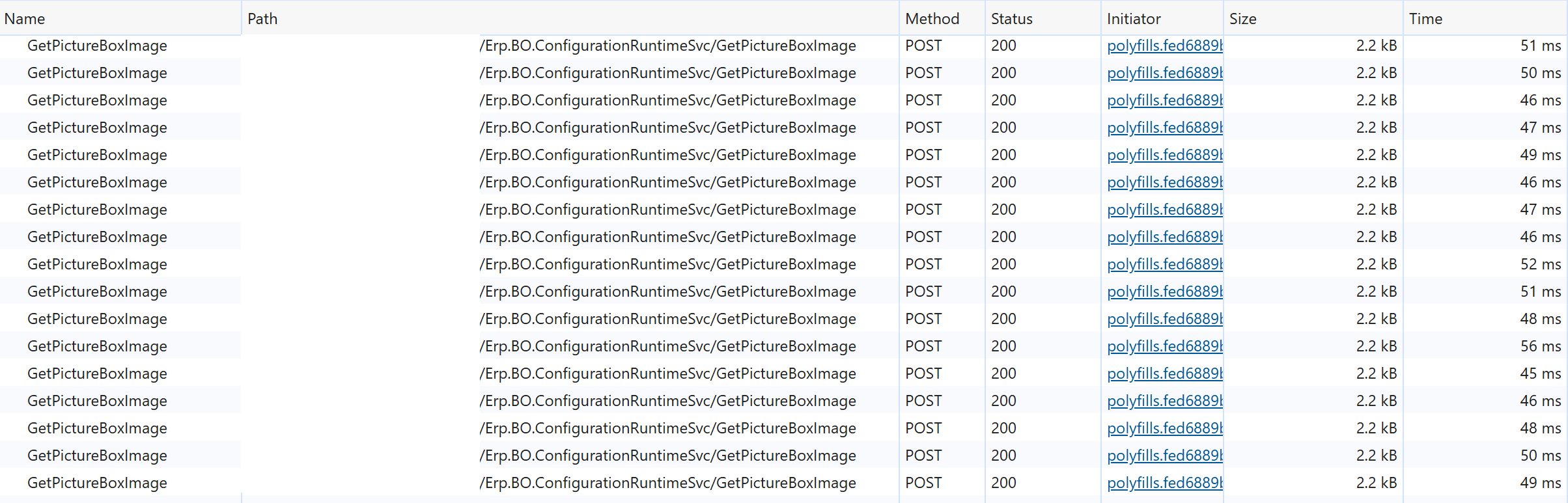

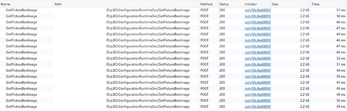

We are experiencing major issues with our configurator since the update last night.
We are now seeing these calls being made for every column that is on the configurator screen:
This is not good. It takes a long time to configure one part.
