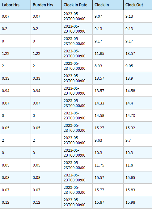

I guess I did not dig deep enough when I saw the load was not changing. Now that I am looking in the LaborDtl table, I can see some of my transactions went in at 0 hours. Ignore everything else I have said. No idea how it happened.
Yep, LaborDtl is a blast. I can see 0 when they are the same, but one would assume that 14.58 - 14.73 would produce hours. Whatever you do, do not ask Jose about clocking in and out at midnight. :frowning:
