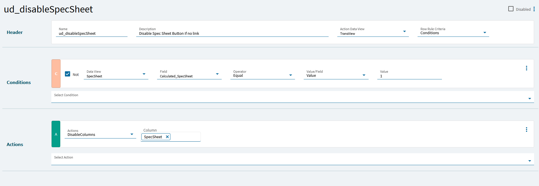

I’m not sure if I’m thinking of it the same way you are, but I used a rule on this one. Since the OrderDtl dataview will be on the row you have selected you could use similar logic to look for non matching category and hide the button.
I did it for MES, used disable instead of hiding, and a BAQ to identify if there was an attached URL that I use in the button to open:
Not sure how this would work since I have to take the part number and look it up in the database to determine to which family it belongs. But, I guess I could determine what the family is before presenting the part number and just hold that value in a dataview column that is not displayed - then I could use the data rule.
Is that what you were thinking?
Thanks. I’ll try that.
