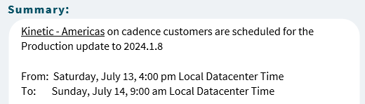

Our system is Cloud on-cadence in the US. Based on these still-current posts I have been planning for the upgrade to 2024.1 in Live on July 19.
But just got a status email message (7/4/24) that says the production upgrade will occur July 13, and there is an Epicare home page banner announcement that also has the July 13 date.
So, which date should I believe?
I don’t understand why they continue to send notifications that are just plain wrong. Every time it happens I open a support case and ask for confirmation of the correct info. I am pretty sure its still the 19th but opened a case when I got that email anyway to get it in writing.

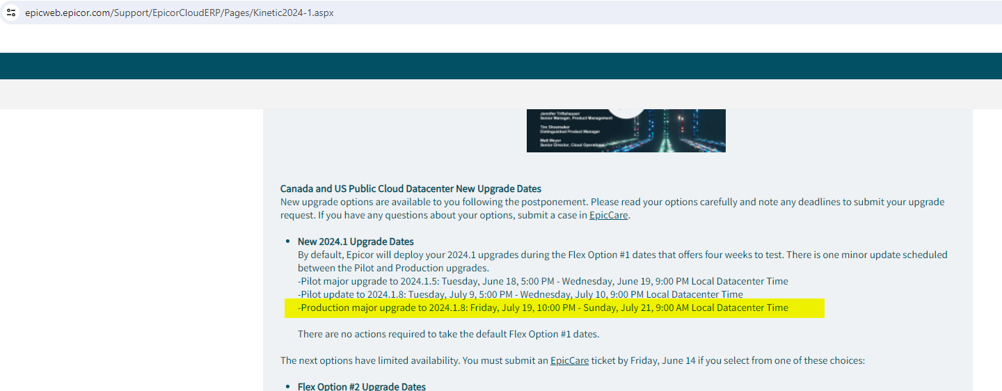

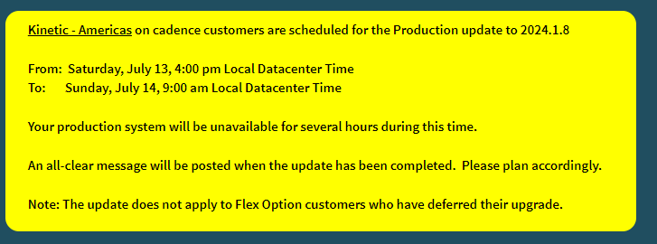

I received the same email announcement…
But when I went to EpicCare (for a completely different reason)… there they have it posted as:
I think the issue was that the email they sent out didn’t have the “G” for Govt. Cloud.
Either that… or they fixed it after they sent out the alert and realized they posted it to the wrong group.

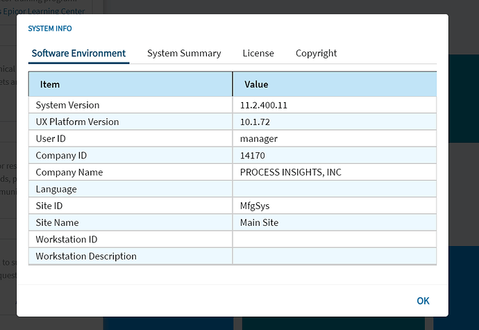

I also got the 2 confusing emails on the dates last week so I filed an EpicCare ticket today with Cloud Ops to clarify. This is how that went. I may have kindled a little dumpster fire :dumpster_fire: to prove a point in the process. For those of you paying attention to the dialog below I think you will find there is still confusion in their answers. I get it everyone of us makes mistakes, including me, but still… Enjoy! :slight_smile:
Epicor Support: For regions that have already had their Production environment upgraded to 11.3.100.5 - we will be updating their system from 11.2.300.5 to 11.2.300.8 on 7/13. In your case - your Production environment is still at 11.2.400.11 - so no action or update will take place on 7/13. Your major Migration to 11.2…300.8 will take place on 7/19
Epicor Support: State: Suggested Resolution
Me: Ok can you please translate your 11.x numbers to 2023.x or 2024.x version numbers please. I realize Epicor uses 2 different numbering schemes but that makes it HIGHLY confusing for us IT admins and users. I am still hopeful Epicor will 1 day adopt a single version numbering scheme.
Epicor Support: Sorry for the confusion Chris. Your Live system is currently on 2023.2.11 and will be upgraded to 2024.1.8 on 7/19-20. You will be getting an update on 7/13 - those are for the regions already on 2024.1 in Production.

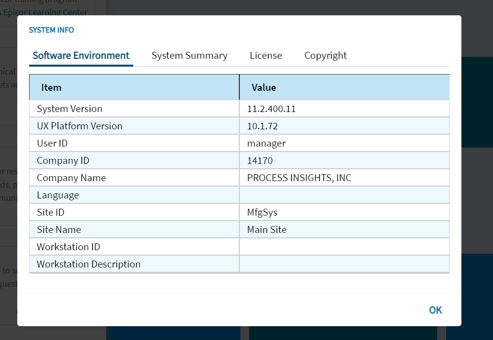

Epicor Released 2024.1 in May 2024 right before Insights in Nashville. Yet the LIVE environments in Public Cloud are still showing 2023.2 over 3 Months Later!!
Our LIVE Production Public Cloud environment current version: 11.2.400 =2023.2!
We are Paying for Public Cloud to be Automatically Upgraded Twice a Year - April/May and September/October and we are NOT FLEX as those windows align with our business operations. If the Upgrade windows are Pushed then we may be Forced to PAY for the FLEX option.
Epicor needs to Remain on their Cadence.
We are in the process of Manually migrating (Re-implementing) from On Premise to Public Cloud and we need to Refresh Live over Pilot to enable the various Testing cycles as we build our system. This Version Mis-Match is majorly affecting our GO Live at end of year!
