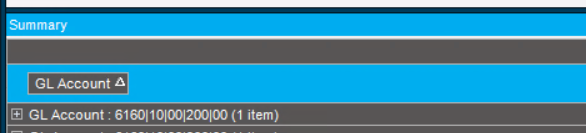

When using 'Group By' on a Table, is it possible to show everything (as if I clicked on every + to expand) when opening the form?
I have a Dashboard and I want to group by GL Account. When I expand a line (by clicking on the + icon), I can see the different periods for each GL Account with the budget and actuals.
I would like that every line is already expanded when I open the Dashboard. I know that I can do it directly in ‘Dashboard’ and then saving and deploying but I need to do it programatically to use the same code later for another dashboard.
Thanks but it seems like it only expends the first row. I don’t understand why.
