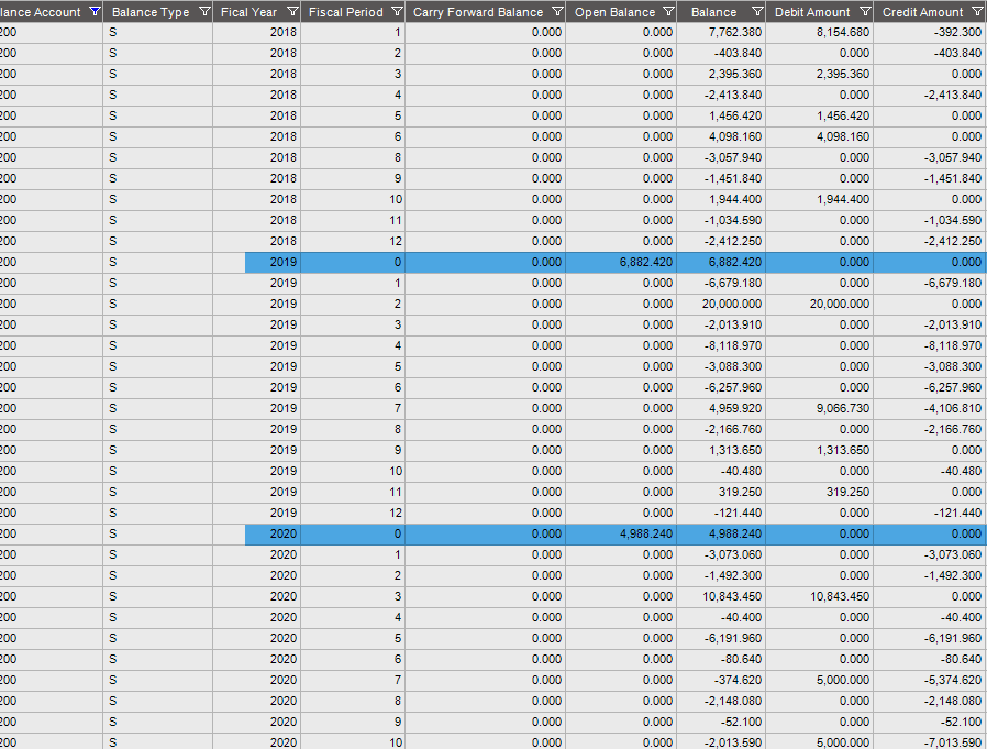

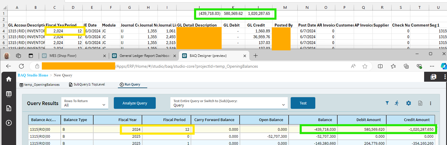

Confirming:
In the table GLPeriodBal - there is an entry for period 0 for each account and it contains the opening balance. If you use an inner join to join it to FiscalPer, it will not return those rows. That was my undoing. I was using the FiscalPer End Date to filter to a relative date range and it was filtering out those rows with 0.
Do you understand how to create a running sum? If so, this should be all you need.
