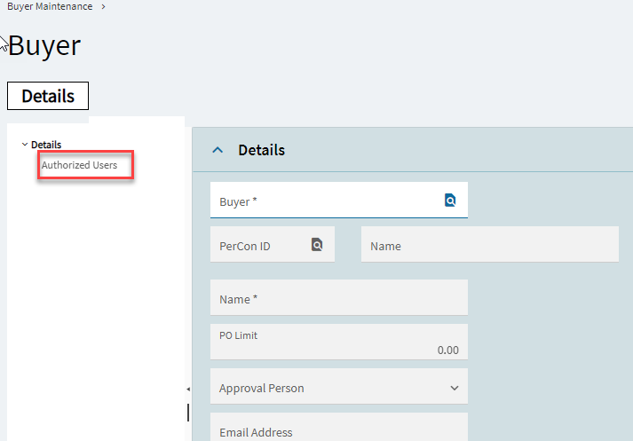

The Buyers need to be Authorized Users to the other Buyers if you want cross-buyer view. This is setup in Buyer Maintenance.
Yes, we currently have all buyers set up as authorized users under each other. We can each view the others Buyer Workbench.
But when the other buyers open NEW PO SUGGESTION screen nothing shows up.

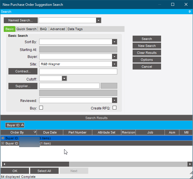

new only opens up for one buyer to keep them only on their suggestions.
if you search and do not specify a buyer and possibly set the return all checkbox you can see all suggestions.
