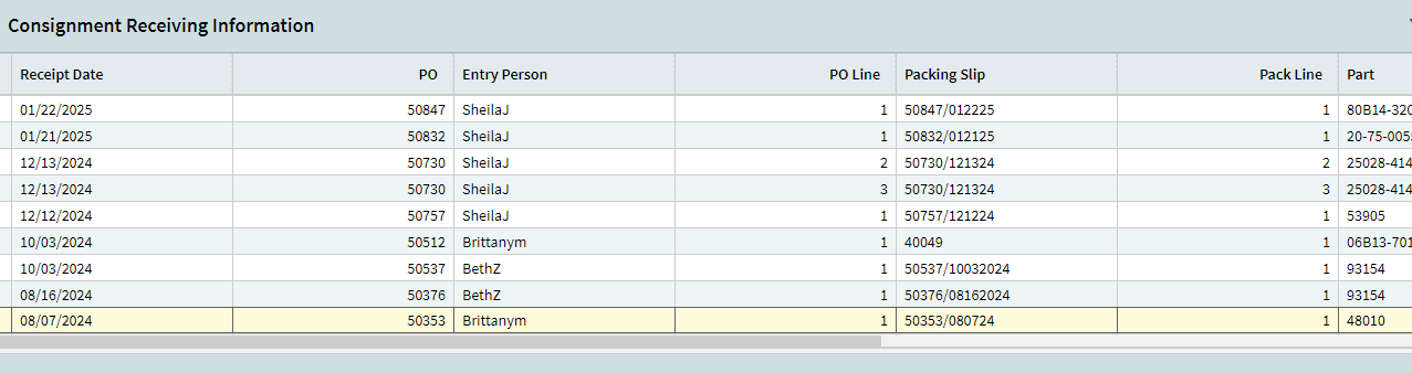

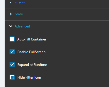

I cannot figure out why the full screen button is removed when the field is enabled? Anyone else seeing this?
Did you try checking Autofill?
Tried… didn’t change the behavior.

“-Kinetic dashboards created in 2024.2 via Classic Dashboard designer, pages will default with new layout (Fit To Page mode ON).”
SOLUTION:
Make the “Fit to Page Mode” disabled thru Layouts.

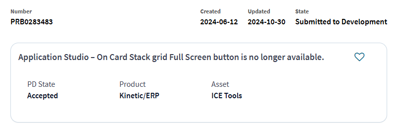

I have narrowed this down to stacked grids. Unstack 'em and the button magically reappears.
This is a known problem - EpicCare Development Request Record - EpicCare
