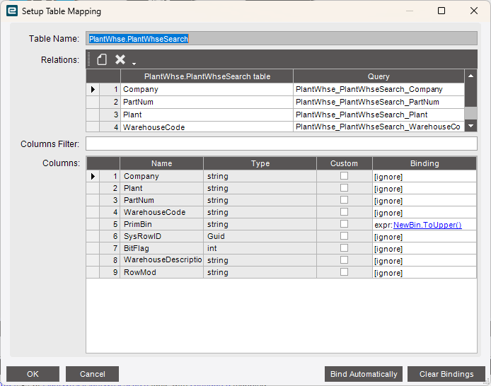

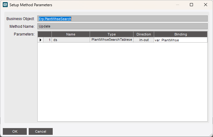

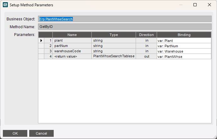

As we migrate our classic customizations to Kinetic, I’m trying to force myself to use widgets instead of code. I figure they will likely weather upgrades better. That said, I have a really simple function that I cannot for the life of me figure out why it’s not writing back to the database. The function is intended to change the primary bin location for a part.
The function has 3 steps.
  1. Invoke BO method - GetByID(PlantWhseDS)
  2. Update Table Query - (PlantWhseDS) with new bin location
  3. Invoke BO method - Update(PlantWhseDS)
Using Postman, the function runs without error (nothing in the server event log either). I have verified that the PlantWhseDS dataset gets loaded correctly with the new bin location, but nothing seems to be written out to the database.

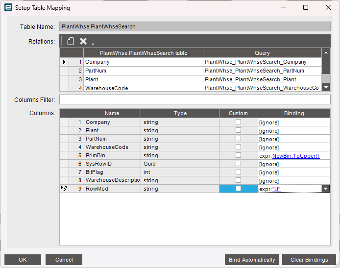

To answer your question, you are likely just missing setting the RowMod to “U”.

Service won’t update using code either, if RowMod is not set

I thought that too, but when I set the RowMod = “U”, the function fails to complete with a server error “Object reference not set to an instance of an object”. I’m likely missing something obvious there.
I am not familiar with the PlantWhseSearch BO. But it looks like you can’t update a primary bin with it. What if you try and use Part BO instead?

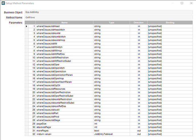

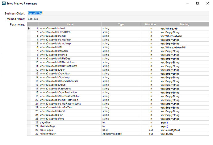

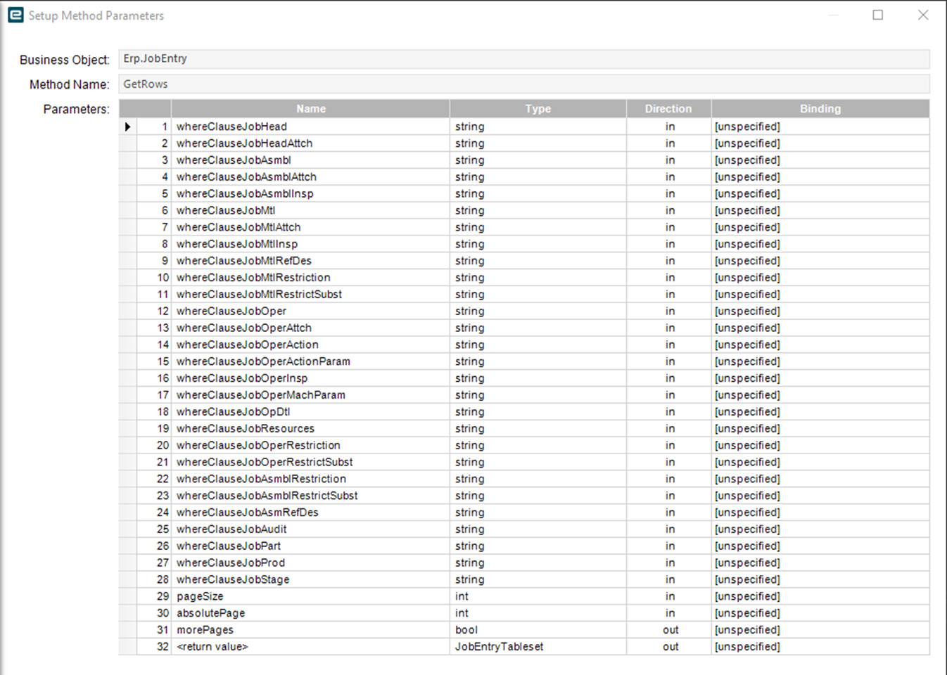

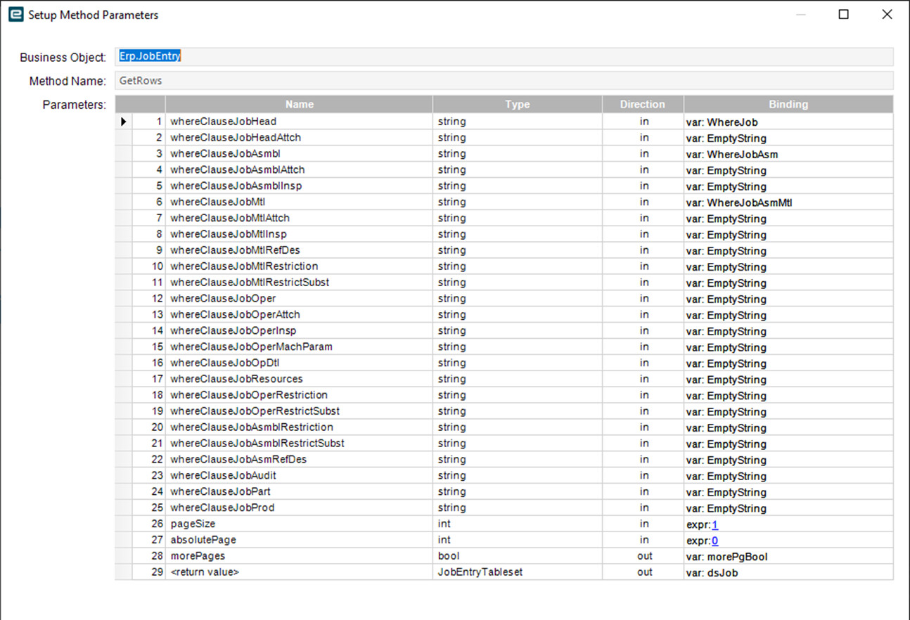

Like in the move to 2022.2, JobEntry.GetRows added 3 new where clauses to the existing 25. So I had to redo every one of these where clauses.
And if it was one EFx, fine. But if you have a dozen that use that BO/method, ugh.
2021 :backhand_index_pointing_up: 2022 :backhand_index_pointing_down:
Yup, that did the trick. Happily accepted the RowMod = “U”. Thank you.
