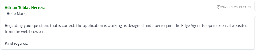

ANY type of link attachment, is being opened with the edge agent.
Internet type link attachments, ie with an url handler (Contains “://”), should be opened with the browser, not shoved off to the edge agent.
This broke a few things that worked perfectly fine in classic.
Non internet url attachments, ie, local links etc, should obviously still be fed to the edge agent.
Yep, even https://epicor.com. :person_shrugging:
Make Attachment Links consistent when requiring when requiring Edge Agent - 6005
this is a bug, you should report it. https:// were supposed to be opened in the browser
I did. CS0004738326.
