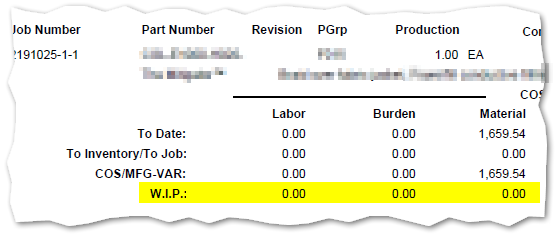

And is there anything in the “W.I.P.” row for said jobs?
I don’t see WIP Cleared Status? Where is that at?
The W.I.P. row shows zeroes for the closed jobs that are still showing on the report.

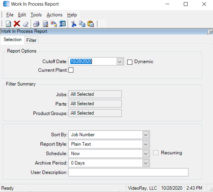

It’s been a while Since I was on V8, so I was guessing that the WIP Report window looked similar to that of E10’s.

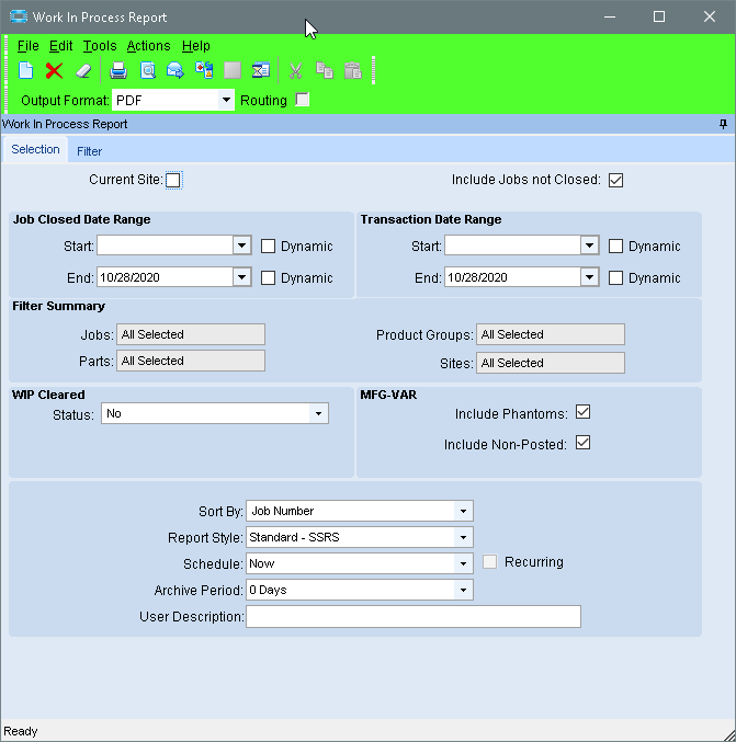

Can you post a screen shot of the WIP Report window? With the window in focus, press ALT+PrtScn. Then in a post here, hit CTRL+V to paste it
Okay, that’s a lot “plainer” than what E10 offers:

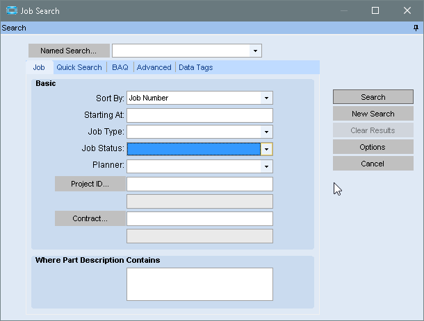

Also, if you go to the Filter tab, can you search on by Job, and use that Job Search to filter out the Jobs to include?
Yeah we can use the Job Filter but we typically like to run it by the part number filter too. So we’d have to search and select all open jobs and add to the filter then do the part number filter as well.
