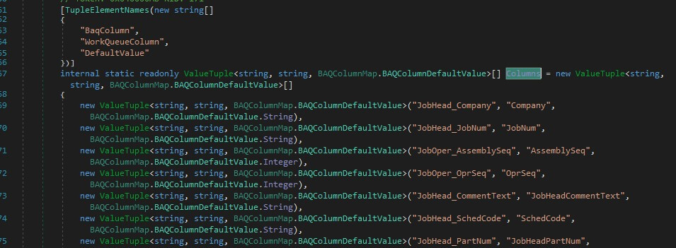

So easy, I copy BAQ, add fields, override event - it calls supposedly my BAQ, but the results dont have my fields.

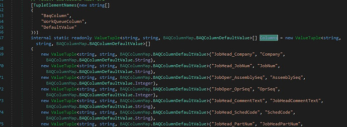

Decompile BO to find that it has hardcoded field mappings.
So what is the purpose of it being BAQ driven? :face_with_bags_under_eyes:

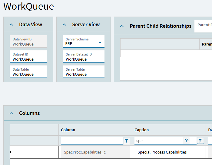

Yeah I saw Number, Character, etc in the mapping so I just hijacked one of those fields with calc field
I added some UD columns to JobOper table and they automagically appeared in the WorkQueue datatable/view.
