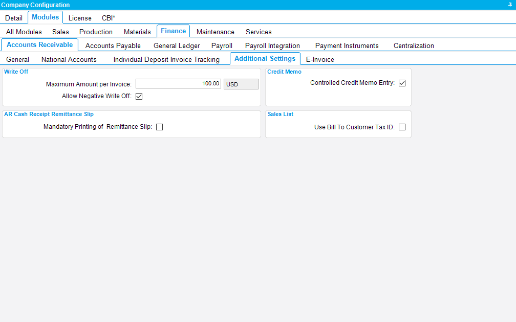

It’s in Company Configuration, on the Modules > Finance > Accounts Receivable > Additional Settings tab:
This was the solution! Couldn’t find this anywhere in documentation. Thank you!
