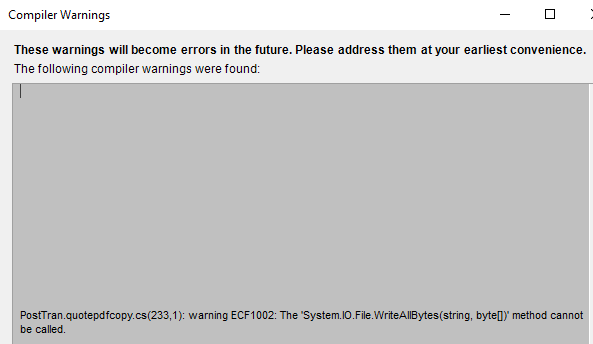

I am getting the below error with this line in a c# data directive when saving the directive:
File.WriteAllBytes(“testrwz.pdf”, bytes);
Is there any other way to write bytes in a data directive BPM in Kinetic 2024.1.12?

Use memory stream to build then output that via email or something? Hard to direct without more information. Looks like you’re trying to create a copy of the Quote PDF file? Pretty sure there are examples on the forums here to do this.
