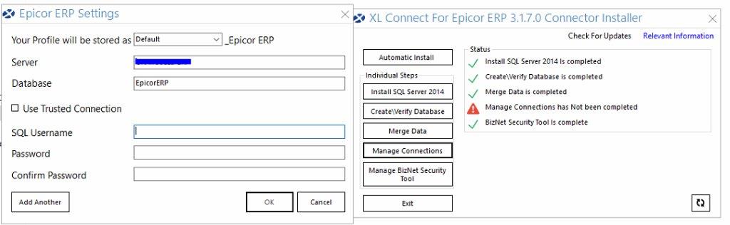

I hope someone can help me. I have huge problems with installation for XL Connect 7.5
Basically on the server I have red triangle with exclamation mark in “Manage Connections”. Can anyone share screen shot and explain what I should enter there?
For me looks like simply task but not working! I tried enter “sa” user and password but cannot establish connection.
Many Thanks for any suggestions.

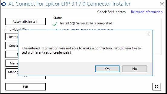

Can you supply a screen shot to jog my memory please.
error2
This should be a 30 sec. task and I spent already 2 days on it…

The documentation on page 9 Shows an image of the Epicor ERP Settings.

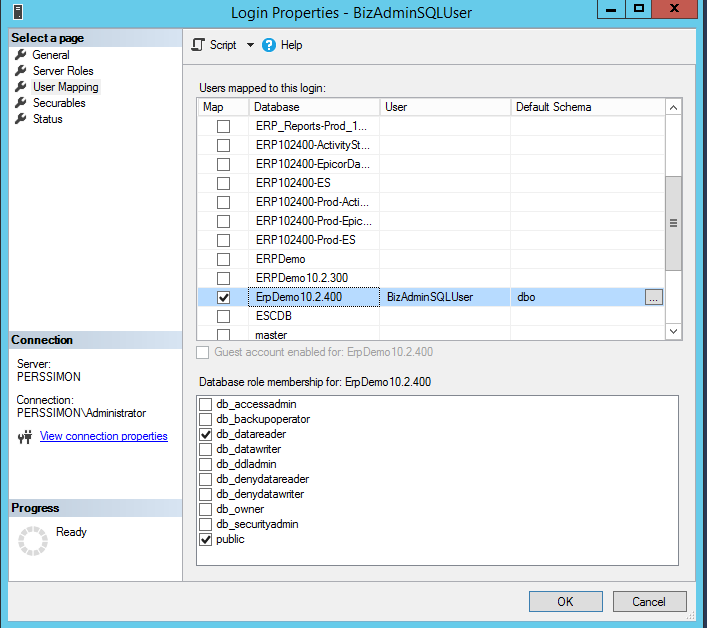

You need to create a new SQL Login using SSMS. Make sure it is Mapped to the EpicorERP database (that’s the field “Database Name” in the Database Connection tab of the Administration console the Application server you want to connect XLConnect to).
You also need to make sure the login has db_datareader rights.
Here is an example I’ve created a SQL login name BizAdminSQLUser and mapped it to the ERPDemo10.2.400 database.
I think this is the bit you might be missing.

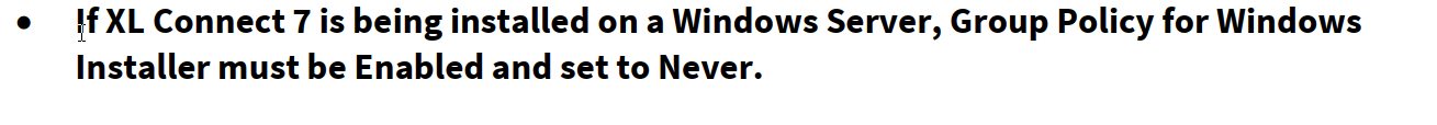

I like this statement on Page 2…It really means nothing.
I believe it is trying to say Windows Installer - Turn Off Windows Installer Setting must me Enabled and set to Never…

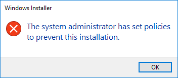

I have a working installation that I want to remove. There does not seem to be one uninstall. Do you perhaps have the steps and tool? On top of that I am getting this message which I am not sure whether it is related to XL Connect or something else on the server:
I have uninstalled other software on this server today.
