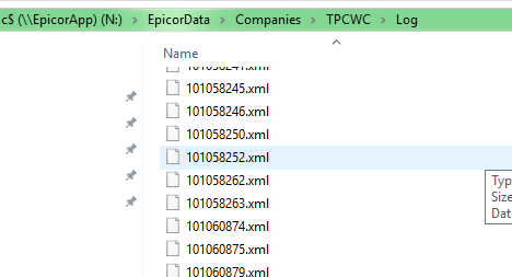

I’ve got LOADS of XML files in the our server log directory containing intquein records going all the way back to when we implemented Epicor. Any idea what these are and if i can delete them? There are like 600 thousand files

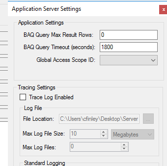

I re enabled it to change the number, but it wasn’t even turned on. So i feel like that is not it.

Avalara writes tons of xml files to EpicorData if you have “debug” mode on, but I think the file names are different than what your pic shows…

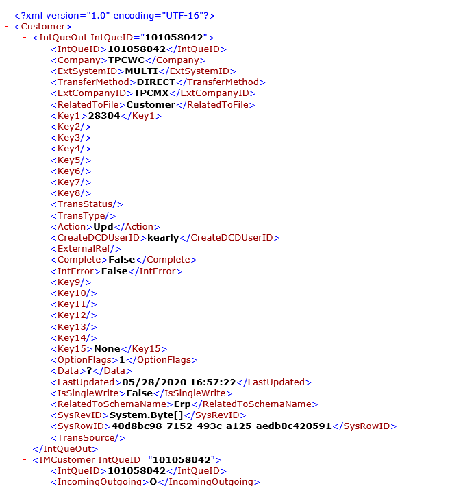

As i said in the OG post, the files seem to contain intquein records. Here is a screenshot of the contents.
Definitely Intercompany records. A file is created every time the task kicks off.

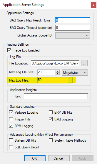

So are these good to delete since these have processed? How can i keep these files under control to not balloon up into the hundreds of thousands.
When I was on SaaS, I believed they had a PowerShell script running to delete (almost) all log files after some number of days. (90 maybe)
